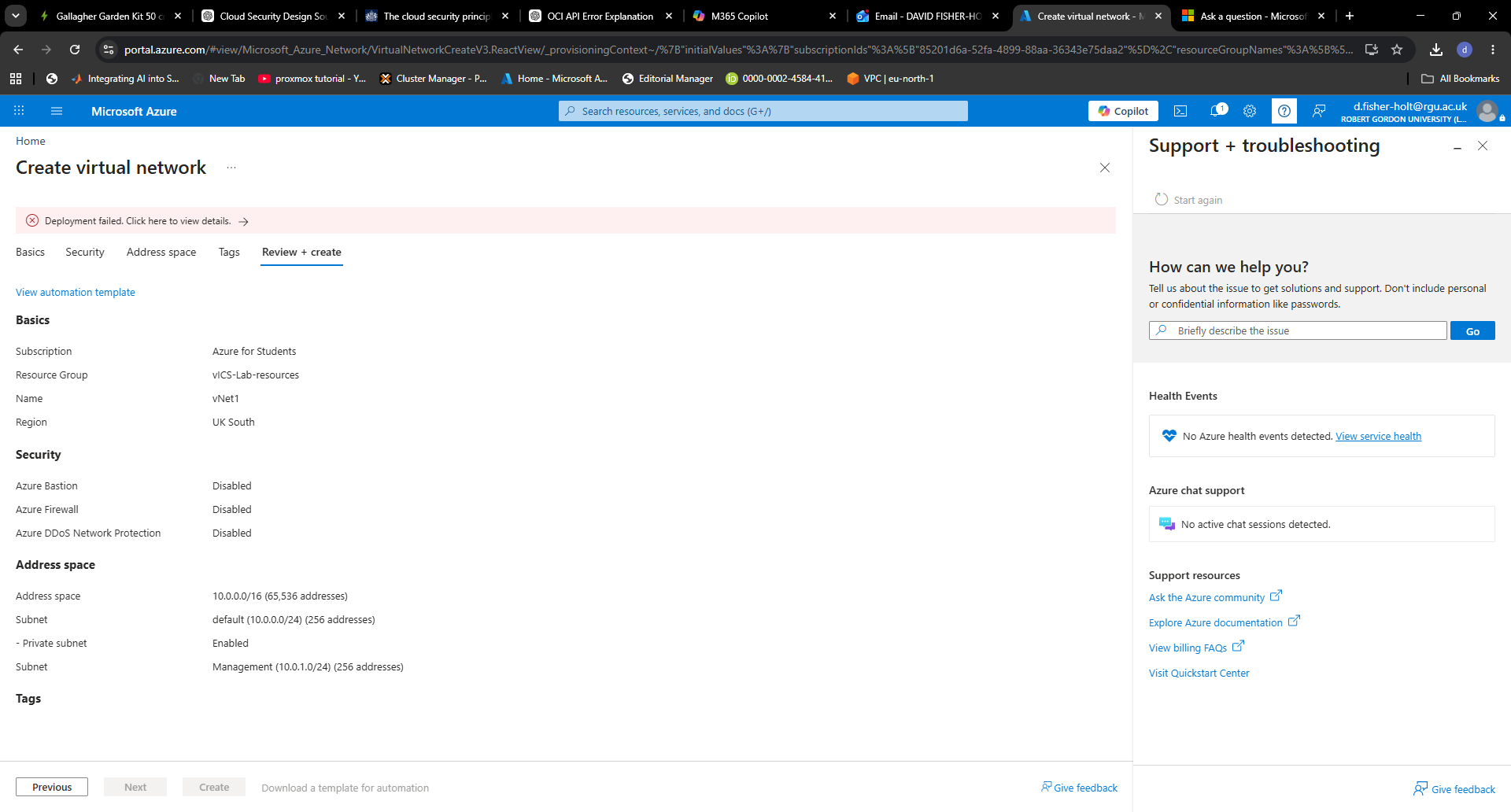

Im having Policy issues - seems I cant build a virtual net in my location?
DFH 20 Reputation points
2026-06-14T20:33:19.8833333+00:00
I User's image
built a simple virtual net, and it verifies fine, but then I get a policy error. When I look into the detailed error, there isn't one. Can't find my way around anything that might guide me - any help welcome. Pulling my hair out here!!

Azure for Students restricts which regions you can deploy resources to. Typically you are restricted to five different regions, and these vary for each person.
Please navigate to Azure Policy -- Authoring -- Assignments using link below:
https://portal.azure.com/#view/Microsoft_Azure_Policy/PolicyMenuBlade/~/Assignments
Click on assignment named Allowed resource deployment regions
Examine Allowed locations Parameter value for list of regions, similar to below (regions in screenshot are different than yours):
The regions shown in your Parameter value are the ones you are allowed to deploy resources to. Please try to create resources in one of these regions and let me know the results.
Thanks.
-TP

  1. DFH 20 Reputation points
    2026-06-15T05:51:11.06+00:00
    Thanks! That worked a treat :-).
