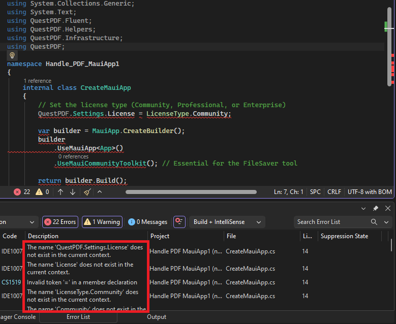

resource attr/colorPrimary (aka com.companyname.handlepdfmauiapp1:attr/colorPrimary) not found.
Jonathan 270 Reputation points
2026-06-12T09:11:30.32+00:00
How to resolve it? I got the issue even if I've rebuilt it.
