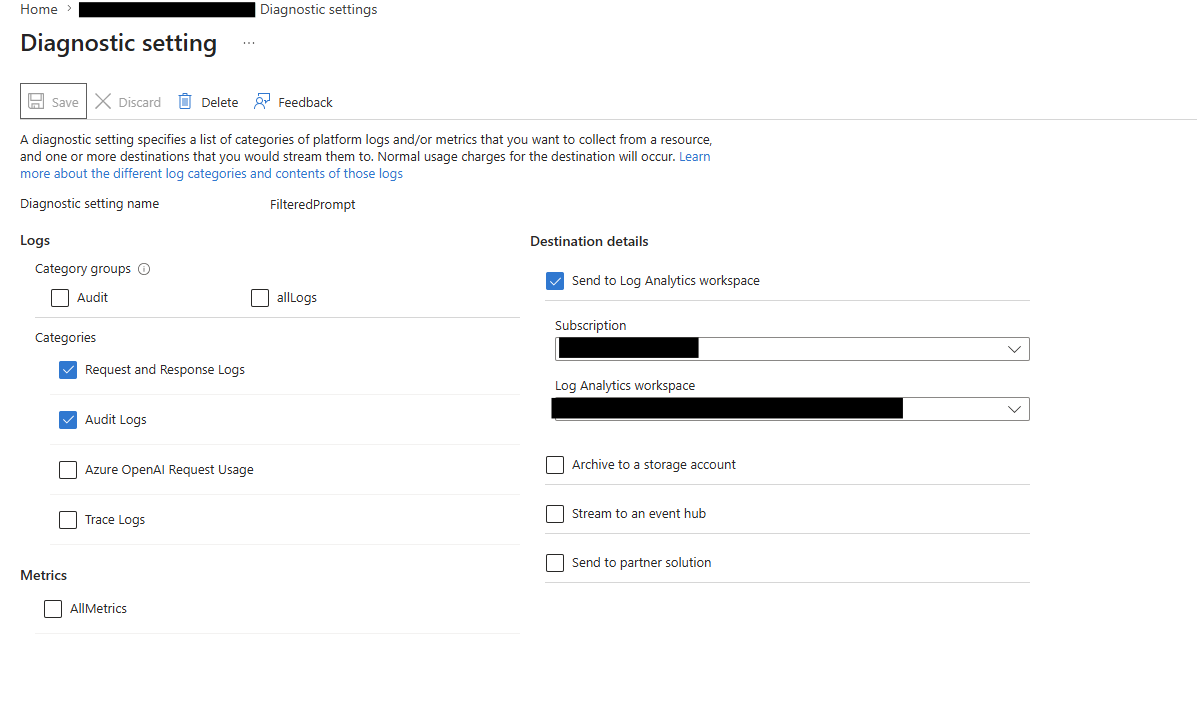

    Step 1 — Enable Diagnostic Settings (this is mandatory first)
    Blocked prompts are NOT logged automatically. You must turn on diagnostic logging before any data starts flowing.
    1. Go to the Azure Portal and open your Azure OpenAI resource in Japan region.
    2. In the left menu, click on "Diagnostic settings" under Monitoring.
    3. Click "Add diagnostic setting."
    4. Select the log category "RequestResponse" (this captures prompt content and filter results) and also "AuditLogs" if available.
    5. Choose "Send to Log Analytics workspace" as the destination and select or create a workspace.
    6. Save the settings. Note that logs will only start collecting from this point forward — past blocked prompts are not retrievable.

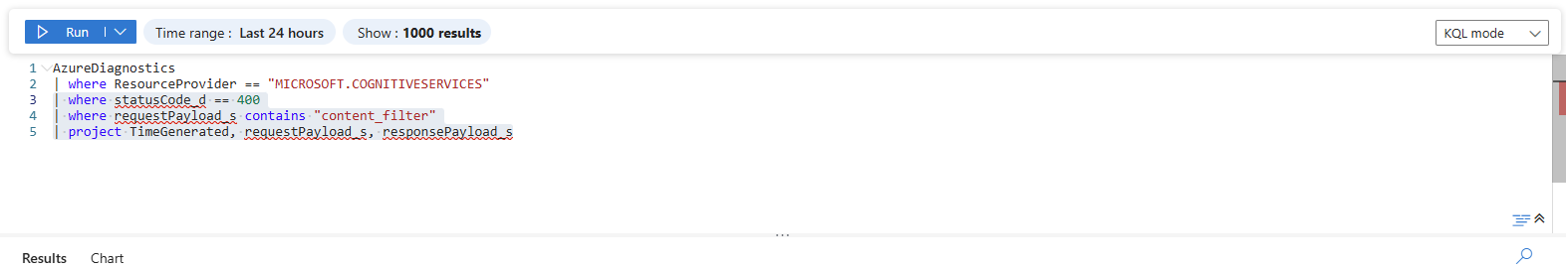

    2. Use the table AzureDiagnostics to query content filter events. Run a query like this to find blocked requests:
    AzureDiagnostics
    | where ResourceProvider == "MICROSOFT.COGNITIVESERVICES"
    | where statusCode_d == 400
    | where requestPayload_s contains "content_filter"
    | project TimeGenerated, requestPayload_s, responsePayload_s
    The responsePayload_s field will contain the content_filter_result object which shows the triggered category (hate, sexual, self-harm, violence, jailbreak) and the severity level (safe, low, medium, high).
    For custom blocklist matches, look inside the content_filter_result for the custom_blocklists field — it will include the blocklist ID that matched the prompt.
