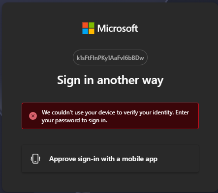

Test 1 (should fail in Edge and other browsers)
  1. Open the browser
  2. Click on the ... menu near the top right and choose New InPrivate Window
  3. Enter microsoft.com.io in the URL field near the top of the window
  4. Click on Sign in near the top right
  5. Type in the e-mail address in the field
  6. Click Next

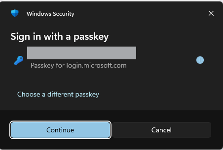

  7. The Face, fingerprint, PIN or security key page should appear and the following popup window should appear User's image
  8. Click on Continue and enter the Windows Hello credentials
  9. A page with the following error should appear in Edge or other browsers (failure): User's image

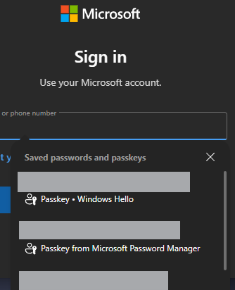

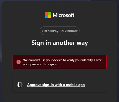

Test 2 (should work in Edge and fail in other browsers)
  1. Open the browser

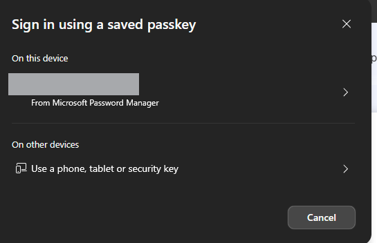

  5. Click in the e-mail field
  6. The Microsoft Password Manager passkey should appear in a dropdown menu.
    In Edge: User's image The result will look slightly different in other browsers

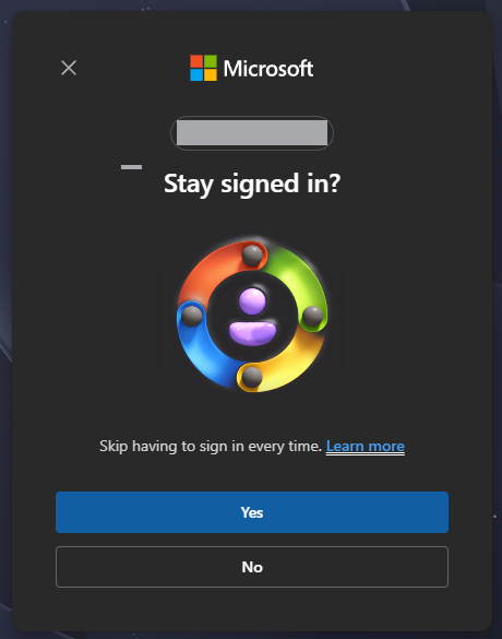

  7. Click on the relevant passkey and enter the Windows Hello credentials.
  8. Result in Edge - a page with the following (success): User's image Result in other browsers - same as in Test 1 (failure): User's image

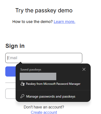

  3. Enter passkeys.io in the RL field near the top of the window

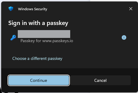

  4. Click in the e-mail field. The passkey in Microsoft Password Manager should appear in a dropdown menu User's image
  5. Click on the passkey and enter the Windows Hello credentials when prompted
  6. Result in Edge and other browsers - a page with the following (success): User's image

  4. Click on the Sign in with a passkey button
  5. In Edge, this window appears User's image In other browsers: User's image
  6. Follow the prompt sand enter the Windows Hello security credentials when prompted
  7. Result: same as in Test 3 (success).
