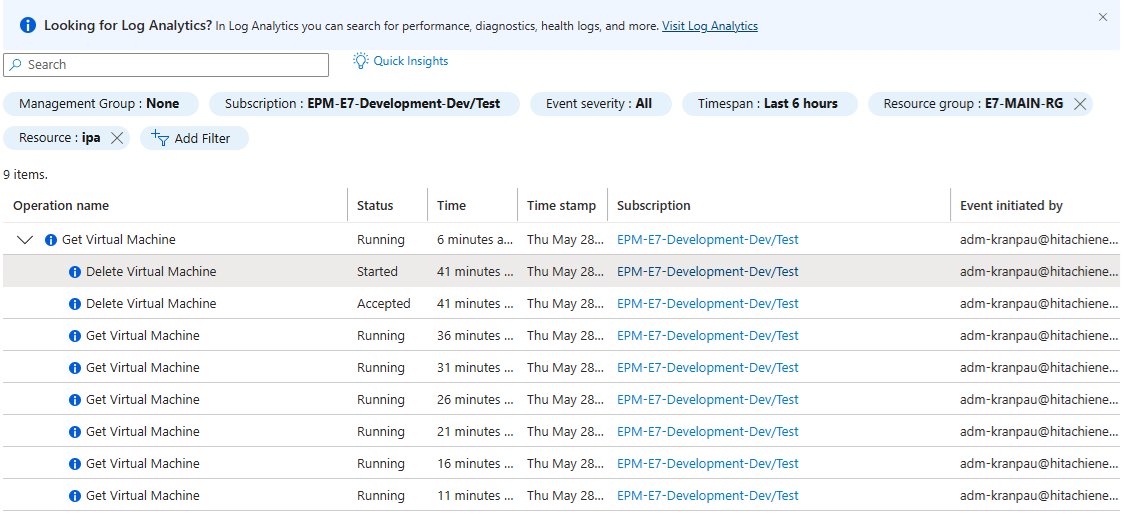

Attempting to delete the VM from the Azure Portal receives the follow error:
  • Resource/subscriptions/<my subscription>/resourcegroups/<my resource group>/providers/Microsoft.Compute/virtualMachines/my virtual machine>
  • Operation name: Delete Virtual Machine
  • Time stamp: Wed May 27 2026 16:58:55 GMT-0400 (Eastern Daylight Time)
  • Event initiated by: <my admin id>
  • Error code: ResourceOperationFailure
  • Message: The resource operation completed with terminal provisioning state 'Failed'.
I have manually deleted the attached disk successfully. It doesn't show up anymore.
I have tried a dozen times to delete the network interface. Azure still shows the network interface. Each attempt to detach the interface - I am met with "No network interfaces available to detach". That network interface is not attached to any other resource.
Every attempt to redeploy the VM fails.
I check for resource locks. The response: "This resource has no locks."
I can attempt to update the VM - "Operation 'Update VM' is not allowed on VM '<my VM>' since the VM is marked for deletion. You can only retry the Delete operation (or wait for an ongoing one to complete)."
When I retry the deletion, without trying to delete any attached resources. The activity log shows that the Deletion has been started but ultimately fails with the first message of this issue - "The resource operation completed with terminal provisioning state 'Failed'."

  1. pkrane 0 Reputation points
    2026-05-28T07:39:40.5733333+00:00
    Accepted. There was Page Blob attached to the resource. I deleted it and am trying the delete again.
