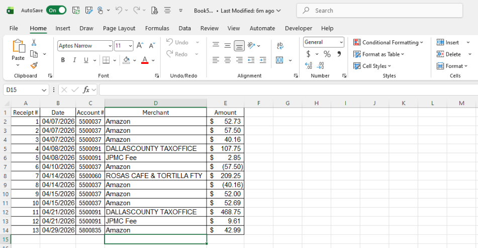

I need to add a line between different account numbers after sorting.
Larry Harrison 0 Reputation points
2026-05-27T20:14:30.5133333+00:00
I am using Excel out of Office 360.
I need to sort a table with dates and account numbers. I need to sort by the account numbers, then add a blank line between the different group of account numbers using a macro.
Is that possible?
Sample data in the file.

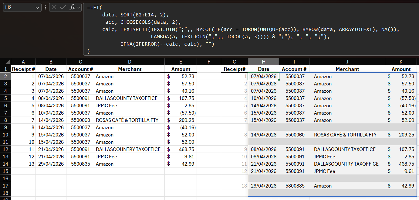

  1. IlirU 2,491 Reputation points Volunteer Moderator
    2026-05-30T09:50:01.49+00:00
    Hi @Larry Harrison
    See if the following formula accomplishes what you are looking for. I have applied the formula to cell H2.
    =LET(
         data, SORT(B2:E14, 2),
          acc, CHOOSECOLS(data, 2),
         calc, TEXTSPLIT(TEXTJOIN(";",, BYCOL(IF(acc = TOROW(UNIQUE(acc)), BYROW(data, ARRAYTOTEXT), NA()),
                         LAMBDA(a, TEXTJOIN(";",, TOCOL(a, 3)))) & ";"), ", ", ";"),
               IFNA(IFERROR(--calc, calc), "")
    HTH
    IlirU

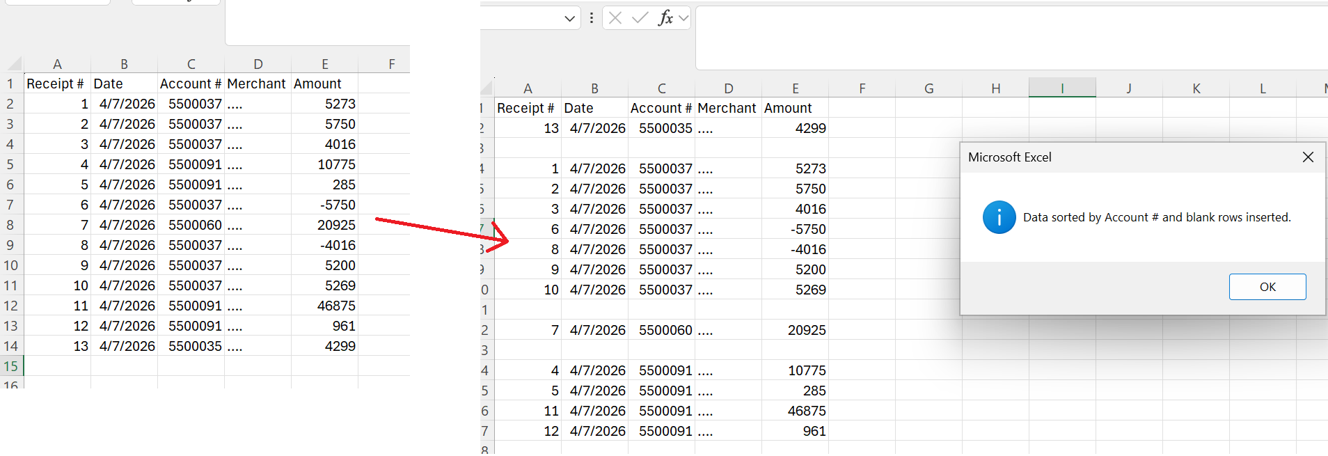

  3. Larry Harrison 0 Reputation points
    2026-05-28T14:06:17.84+00:00
    What I need is to sort the data by the account numbers then add a blank line between the different account numbers.
  4. Vy Nguyen 11,150 Reputation points Microsoft External Staff Moderator
    2026-05-27T20:55:53.01+00:00
    Hi @Larry Harrison
    I hope you are doing well today.
    Based on the information you shared that you would like to sort a table by account numbers and then automatically insert a blank row between each group of account numbers using a macro in Excel (Microsoft 365).
    This is certainly something that can be achieved, and I would be more than happy to assist you with building the right solution. However, in order to make sure the macro is tailored accurately to your specific file and data structure, I would like to gather a few more details before moving forward.
    Could you kindly help me with the following questions?
    1. Could you please share the sample file you mentioned or a screenshot of your data so I can better understand the layout?
    2. In terms of grouping, what criteria do you use to determine that two account numbers belong to different groups? For example, is it based on a completely different account number value or a specific pattern within the number?
    3. Could you also describe or illustrate what the expected output should look like after the macro runs, particularly where the blank rows should appear in relation to your sample data?
    Once I have these details, I will be able to prepare a complete and accurate solution that works seamlessly for your situation.
