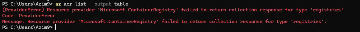

I can not access acr service
Md Azimul Islam Sheblu 0 Reputation points
2026-05-21T06:37:47.4566667+00:00

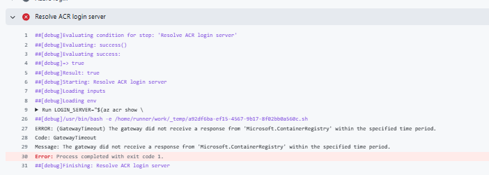

I noticed it first in my ci/cd pipeline, and then also run acr related commands in azure cli, it also shows the error
now can anyone tell me issues? why this is happening?

  1. Himanshu Shekhar 6,420 Reputation points Microsoft External Staff Moderator
    2026-05-21T08:12:46.48+00:00
    Md Azimul Islam Sheblu - We would like to inform you of an ongoing service degradation affecting Azure Resource Manager (ARM) and Azure Container Registry (ACR).
    At present, customers in Southeast Asia and multiple other regions may experience:
    1. Increased error rates
    2. Request timeouts
    3. Intermittent failures (including 504 Gateway Timeout / Service Unavailable responses)
    Our engineering teams are actively investigating the issue and working on mitigation efforts to restore normal service as quickly as possible.
    We will continue to keep you informed as we receive further updates. In the meantime, we recommend retrying failed operations, as some requests may succeed intermittently.
