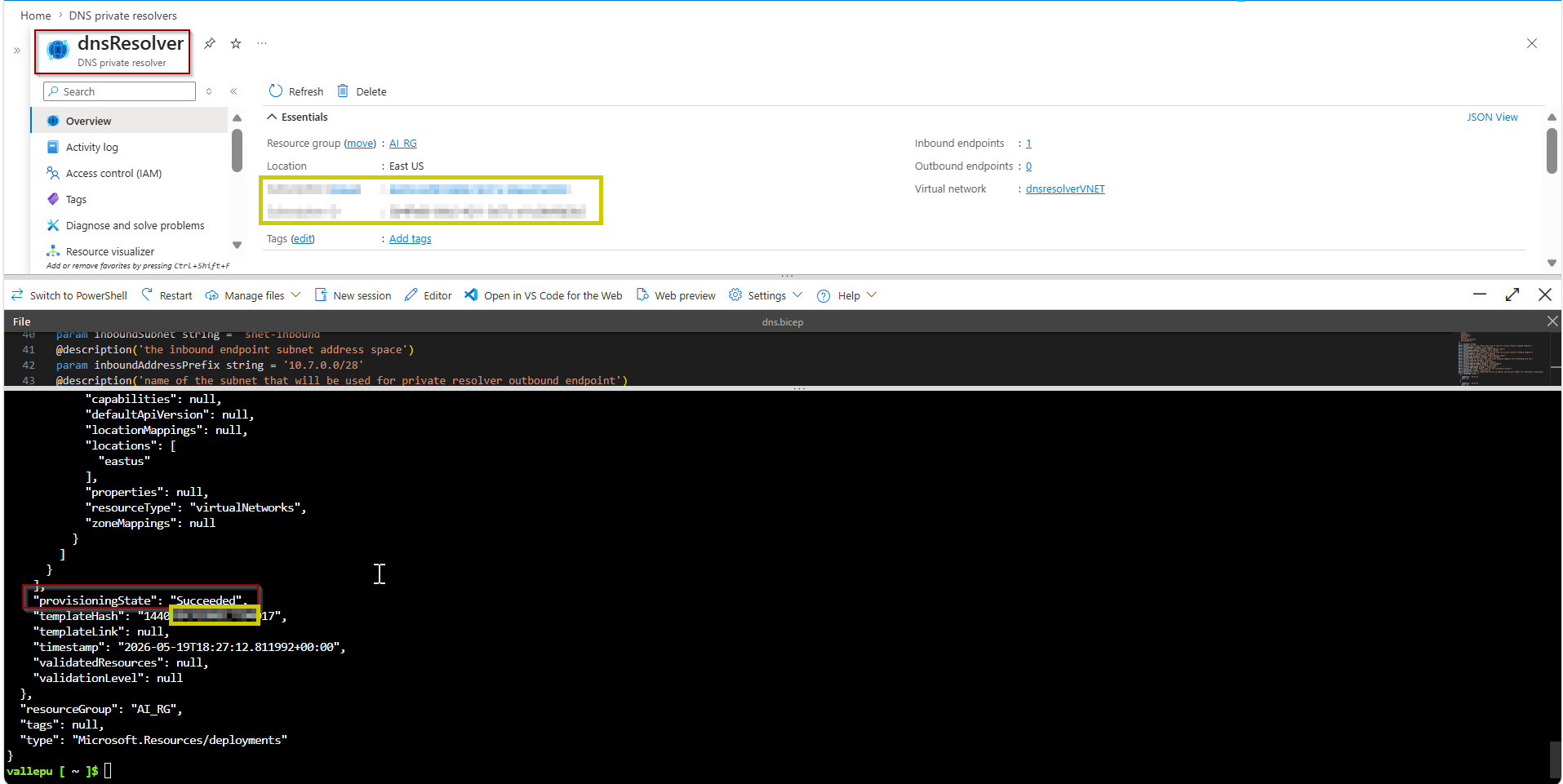

    2. Since the delete operation is also failing with the same backend error, this indicates the DNS Private Resolver resource is likely stuck in a failed provisioning state within the Network Resource Provider. The key indicators are: InternalServerError and circuitBreaker=``[state=Open] I tried to create the DNS Resolver with an inbound endpoint using the below Bicep code with API version Microsoft.Network/dnsResolvers@2022-07-01, and the deployment completed successfully.

    Output
    If the above steps did not help resolve your issue, please feel free to share the details in a private message so we can proceed with further troubleshooting over a Teams call. I am happy to connect with you on Teams to investigate and resolve the issue.
