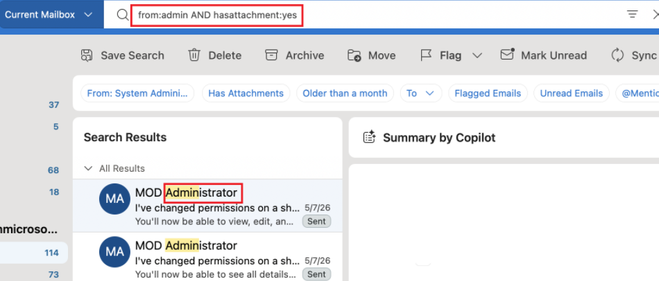

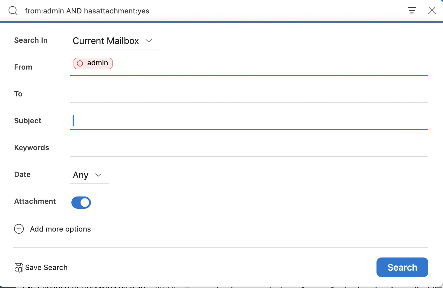

Hi RB20689
May I ask what is your New Outlook version? You can check this in Outlook > About Outlook.
I am testing on version 16.109 and advanced search works normally. However, I do see the same behavior if you only enter a part of an email address, it will not recognized as a valid sender.
Despite of that, it will still return the result normally.
Another alternative you can do is directly enter the query instead of choosing from the UI. For example:
from:<keyword of sender> AND hasattachment:yes AND to:<keyword of recipient>
So, make sure you have updated your Outlook version to the latest. If the issue persists, you can uninstall it and reinstall the latest version here: Update history for Office for Mac - Office release notes | Microsoft Learn
Please try and let me know how it goes.
