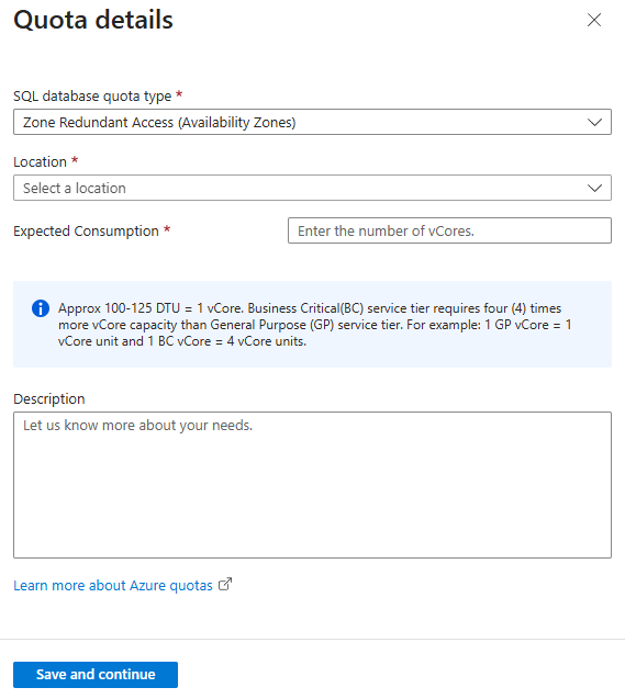

    6. Now you should be on Additional details tab. Click Enter details
    7. For quota type select Zone Redundant Access (Availability Zones), select Location, enter expected number of vCores, and then click Save and continue
    quota details flyout
    8. Finish filling out Additional details tab, click Next, review and click Create. You should receive an automated email within a few minutes.
