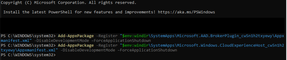

    Based on your information, error 3399811147 typically occurs when the Office desktop app fails to authenticate, even though web-based sign-in works. This usually points to an issue with the Windows Account Manager (WAM) authentication broker since your account functions correctly in the browser.
    Please try these initial troubleshooting steps first:
    1/ Repair Windows Account Manager (WAM)
    To re-register the authentication broker component, open Windows PowerShell by typing PowerShell in the search bar, then right-click and select Run as administrator. Copy and paste the following command for work or school accounts:
    Add-AppxPackage -Register "$env:windir\SystemApps\Microsoft.AAD.BrokerPlugin_cw5n1h2txyewy\Appxmanifest.xml" -DisableDevelopmentMode –ForceApplicationShutdown
    Press Enter and wait for completion. After that, run this second command:
    Add-AppxPackage -Register "$env:windir\SystemApps\Microsoft.Windows.CloudExperienceHost_cw5n1h2txyewy\Appxmanifest.xml" -DisableDevelopmentMode –ForceApplicationShutdown
    User's image Once both commands have finished, close PowerShell.

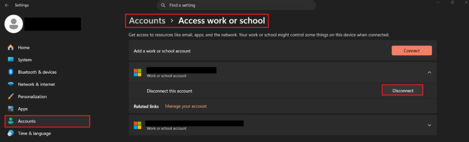

    2/ Disconnect and your account
    Go to Settings > Accounts > Access work or school. Locate your work or school account, click on it, and select Disconnect. Confirm the removal when prompted.

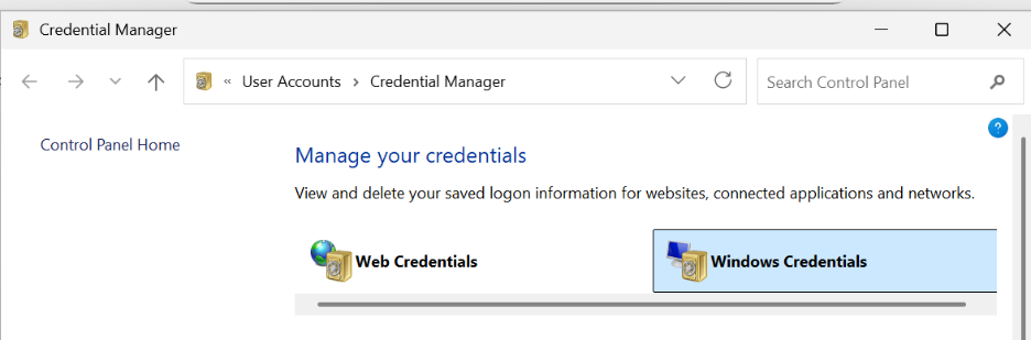

    3/ Clear Windows Credential Manager
    Open Credential Manager by searching for it in Windows. Select Windows Credentials, then look for and remove any entries related to MicrosoftOffice16_Data, Outlook, Office365, or your email address. User's image
    After completing these steps, restart your computer and try signing in to OneNote again.
