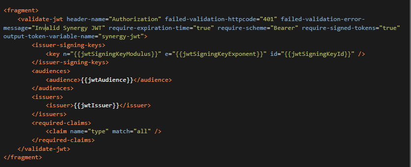

we have an APIM policy attempting to validate incoming JWT using public key modulus, exponent and id.
This policy however seems to not validate JWT signature for some reason. When I change key modulus, exponent or id, the validation still passes and request is forwarder to backend. If I change audience or issuer in the policy, the validation fails as expected.
What is the proper way to validate incoming JWT when we only have acess to public key of the identity provider?
