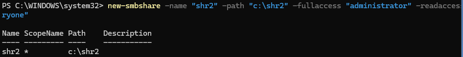

On Powershell (of server 2025), I shared the SMB path like
圖片

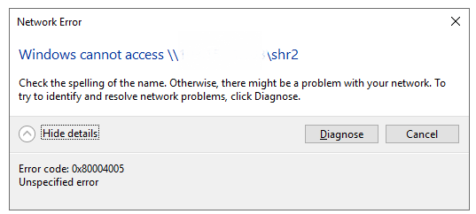

but I got the problem below to access the shared path. Please help.
圖片

    Everyone is not always "everyone".
    If the user on the client PC is logged in with a local account, then the server cannot authenticate it unless you have defined a local account with the same name and password on the server.
    On the client PC, open a command prompt and run "net view". If the account can be authenticated, then you should see SHR2 listed.
    net view \\ServerName
    If "net view" works, then you likely have a permissions problem on either the share or the folder. This script will report on shares.

    Error 0x80004005 with SMB shares is often caused by permissions, firewall settings, or SMB authentication issues rather than the New-SmbShare command itself.

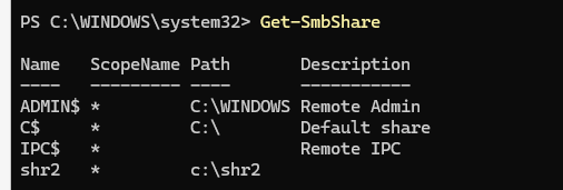

    Get-SmbShare

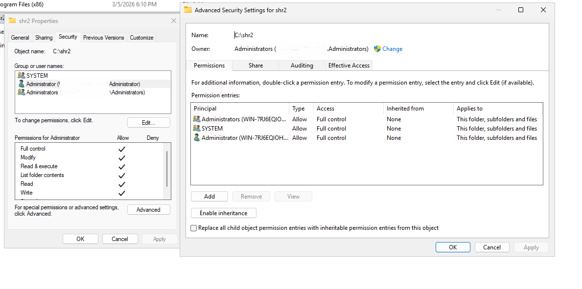

    The folder C:\shr2 actually exists.
    NTFS permissions on the folder allow access.

    The error you’re seeing (0x80004005) usually indicates that the SMB share was created but cannot be accessed due to either permissions or name resolution. In your PowerShell command, the -readaccess "ryone" looks like a typo — it should be a valid local or domain account (for example, Everyone). If the account name is invalid, the share is created but access fails. Also confirm that the folder C:\shr2 actually exists and that NTFS permissions allow the connecting user to read or write as intended; SMB share permissions alone are not sufficient if NTFS denies access.
    On Windows Server 2025, make sure the “File and Printer Sharing” inbound firewall rule is enabled, and that the SMB protocol is not blocked. Test connectivity by running \\servername\shr2 from a client, ensuring the server name resolves correctly in DNS. If you want anonymous access, explicitly grant Everyone read access both at the share and NTFS level. If you intend to restrict it, use proper domain accounts instead of local placeholders.
    In short, correct the access parameter to a valid identity, verify NTFS permissions on C:\shr2, and ensure the firewall allows SMB. Once those are aligned, the share will be accessible without the 0x80004005 error.

    Error code 0x80004005 when accessing an SMB share typically indicates a connectivity or name resolution problem rather than the share definition itself.
    Use these checks on the Server 2025 machine and from the client:

      • On the server, confirm the share exists:
        • Get-SmbShare | Where-Object Name -eq 'shr2'
