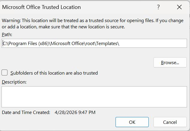

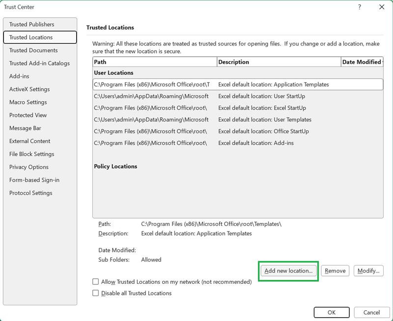

    Step 5: Use a Trusted Location
    Instead of enabling macros repeatedly, store the workbook in a Trusted Location: Open Excel > Go to File > Options > Trust Center > Select Trust Center Settings > Trusted Locations > Click Add new location and choose the folder containing the .xlsm file.
    (Optional) Enable Subfolders are also trusted.
    Click OK, close Excel, and reopen the file.
    Files opened from trusted locations will run macros without warnings.
