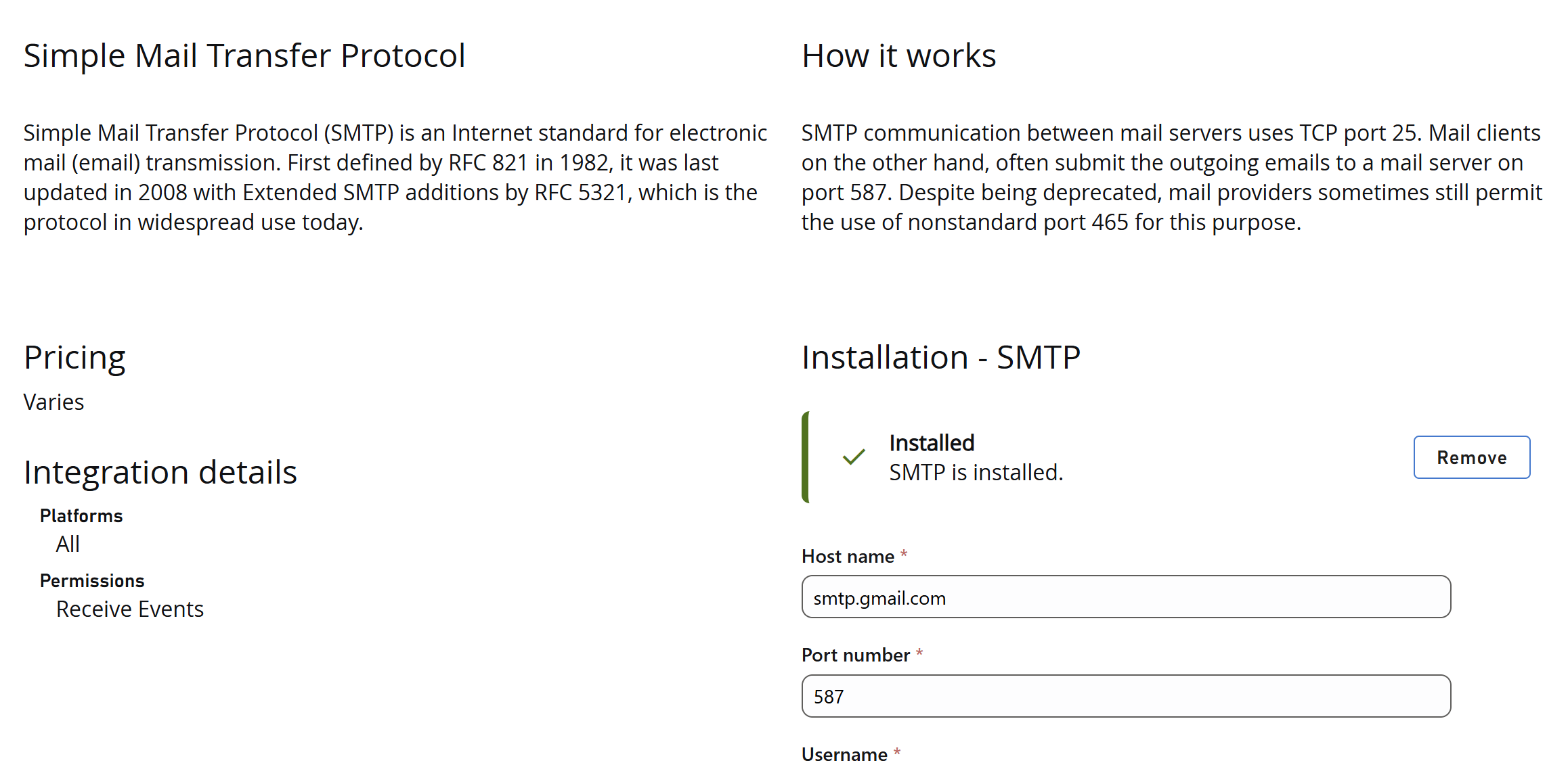

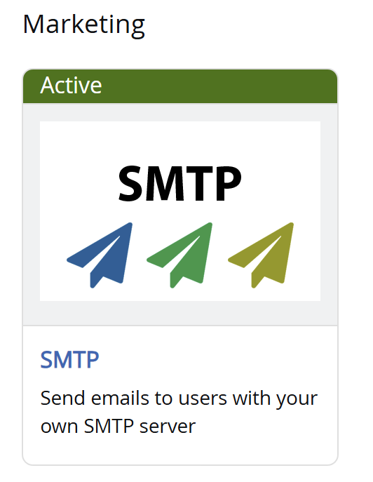

In PlayFab the SMTP Addon is active and I have not changed the settings:
Screenshot 2026-05-06 114947

    It looks like your PlayFab call to SendAccountRecoveryEmail is reaching your SMTP server but failing with:
    “The SMTP server requires a secure connection or the client was not authenticated. The server response was: 5.7.0 Authentication Required.”
    In most cases this means your SMTP provider (Exchange Online, Gmail, etc.) is blocking Basic Auth or your PlayFab SMTP add-on isn’t configured correctly.
    Go to https://myaccount.google.com/, Click "Security", enable Two-step Verification, once done, come back to the myaccount Security page, you will see "App passwords", open that, it will give you options for what you are trying to make a password for (a bunch of devices), select "Windows Computer", make a password, copy it, use this password in your code.
    Once you've turned on 2-step verification in your Google account, you need to use that 16-digit app-specific password in your PlayFab SMTP add-on instead of your normal Gmail password. Only an app password will let PlayFab authenticate to smtp.gmail.com when MFA is enabled on your account.
    Hope this helps!
    If the resolution was helpful, kindly take a moment to click on User's imageand click on Yes for was this answer helpful. And, if you have any further query do let us know.

    This indicates the SMTP server is rejecting PlayFab’s attempt to send mail because either:
    • SSL/TLS is not enabled or not matching what the SMTP server requires, or
    • The username/password (or app password) configured for the SMTP server is no longer valid, or
    • The SMTP provider has tightened security (for example, now requiring SSL/TLS or app passwords instead of “less secure apps”).
    To fix this, update the SMTP configuration for each affected PlayFab title:
    1. Verify SMTP server requirements
      • Confirm with the SMTP provider which port, encryption, and authentication are required (for example, TLS on port 587, SSL on 465, or specific app passwords).
      • If using a provider like Gmail, ensure SSL is enabled and, if two-step verification is enabled, use an app password or enable access for less secure apps as required.
    2. Update PlayFab title SMTP configuration
      • In PlayFab Game Manager, open each title (both title IDs used by the two Azure Function projects).
      • Go to the email/SMTP configuration section used for sending emails.
      • Ensure:
        • SMTP host, port, and SSL/TLS settings match the provider’s current requirements.
        • SMTP username and password (or app password) are correct and not expired or revoked.
      • Save the updated configuration.
