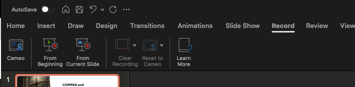

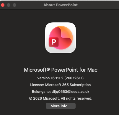

  1. Harbinder Singh [dfjq0653] 0 Reputation points
    2026-08-09T12:21:43.39+00:00
    I am having the same problem, I bunch of animations within quite a few slides, and it's just not working when I select record. Please help, it will affect my submission and score for my course.
    User's imageUser's image
  2. Kai-H 26,135 Reputation points Microsoft External Staff Moderator
    2026-05-01T07:30:40.91+00:00
    Hi, David Paiko
    This does sound like the recording window is not reading the animation sequence correctly, rather than a problem with the animations themselves, since they still work in normal Slide Show mode.
    Besides the solutions provided by the Q&A Assist, here are some suggestions you can try:
    It is recommended that you test the older/classic recording path if available: enable the Recording tab, then use Record Slide Show from there instead of the newer Record interface. Also try changing one test animation from On Click to After Previous or With Previous, then record again. This helps check whether the issue is only with manual click triggers in Record mode.
    If you mainly need the final video, the most practical workaround is to play the presentation normally using Slide Show from Beginning, then capture it with a screen recorder instead of PowerPoint Record mode. Since the animations work there, the recording should capture what you actually see.
    If the same problem happens in a brand-new file and another Windows profile, I would also report it through Microsoft Support or Feedback Hub, as that points more to a PowerPoint recording-mode problem than a file issue.
    Thank you for your patience in reading, I hope this information has been helpful to you.
