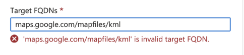

    Azure Firewall Premium SKU already supports URL/path-level filtering for outbound traffic. The limitation you discovered (only FQDN-based filtering) applies to Azure Firewall Standard, not Premium. Your current setup can whitelist fine-grained URLs like maps.google.com/mapfiles/kml without opening the entire domain.
    What you need to configure correctly:
    Create an Application Rule (never use Network Rules for URL paths)
    Enable TLS inspection on that Application Rule (required for HTTPS URL filtering)
    Set Destination Type = URL (not FQDN)
    In the Destination field, enter the full path without http:// or https://, for example: maps.google.com/mapfiles/kml or *.google.com/mapfiles/kml* User's image
    Once configured this way, Azure Firewall Premium will evaluate the entire URL including the path, not just the domain name.
