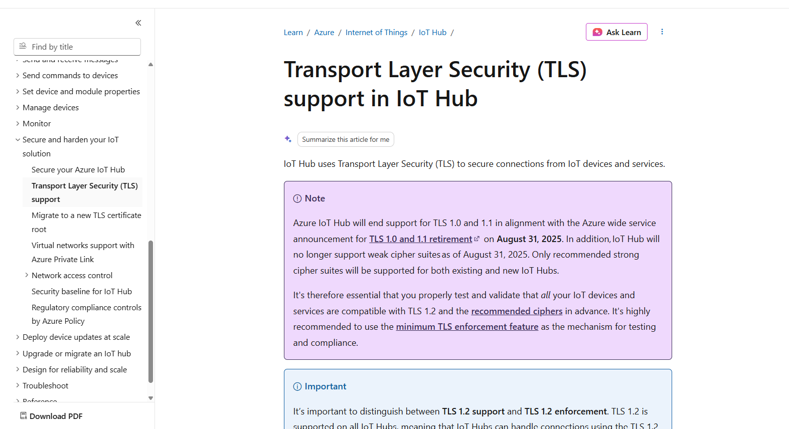

Tonight we encountered an issue with our IotHub where ~1500 devices could not connect anymore. Our IotHub is currently operating under a temporary exception for legacy TLS 1.0 version.
grafik
Only then we noticed that this subset of our devices support TLS1.2 but do not support a required cipher suite (the devices offer TLS_RSA_WITH_AES_256_CBC_SHA). Since their firmware cannot be updated, the devices need to be replaced in the field.
My question is: How long can we run under that temporary exception to allow legacy cipher suites? We cannot afford to lose the device connections until we replaced them in the field which takes at least a few months.

    It did not show last date extension in backend with similar query from procured from another thread.
    But as per SMEs, you can re-apply on this form to check feasibility of extending the exception (TLS 1.0) beyond Aug 31, 2025 (Feasible, limited and approval only)
    You can query last extension date on the email when you receive the reply from IOT hub gating team.
    Also, would suggest looks for firmware update or start replacing devices with TLS 1.2 or higher support already (25-50% of all devices incrementally)
    Status on 08th June- Customer in sync with product group for negotiations and extension of TLS 1.0 usage.
