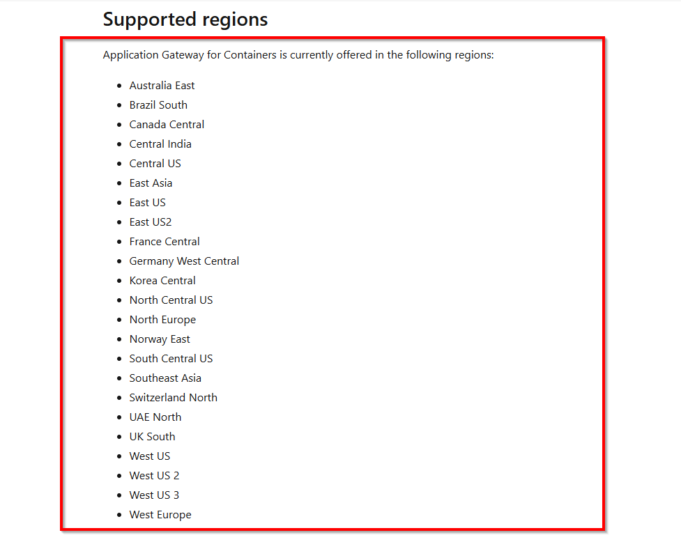

  1. Venkatesan S 7,635 Reputation points Microsoft External Staff Moderator
    2026-04-21T09:58:55.9866667+00:00
    Hi Akira Kawakami,
    Thanks for reaching out in Microsoft Q&A forum,
    Is there a known platform issue with Microsoft.ServiceNetworking/trafficControllers/associations creation in japaneast right now? I got an update from PG team the Japan east is not a supported region for Application Gateway for Containers
    Because of this:
    • The Traffic Controller resource may still be created successfully.
    • However, the association provisioning fails with InternalServerError since the required ServiceNetworking data-plane infrastructure is not deployed in that region.
    Please deploy Application Gateway for Containers in one of the supported regions listed in the official documentation:
    Reference:
    What is Application Gateway for Containers? | Microsoft Learn
    Please do not forget to 210246-screenshot-2021-12-10-121802.pngand “up-vote” wherever the information provided helps you, this can be beneficial to other community members.
