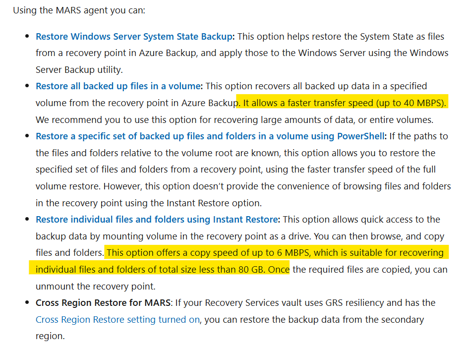

    MARS agent supports these restore scenarios only:
    • Restore individual files and folders (Instant Restore up to ~6 MBps, suited for total size under 80 GB)
    • Restore all backed-up files in a volume (up to ~40 MBps, suited for larger data)
    • Restore Windows Server System State
    • Cross Region Restore (if enabled)
    Reference: About restore using the MARS agent.
