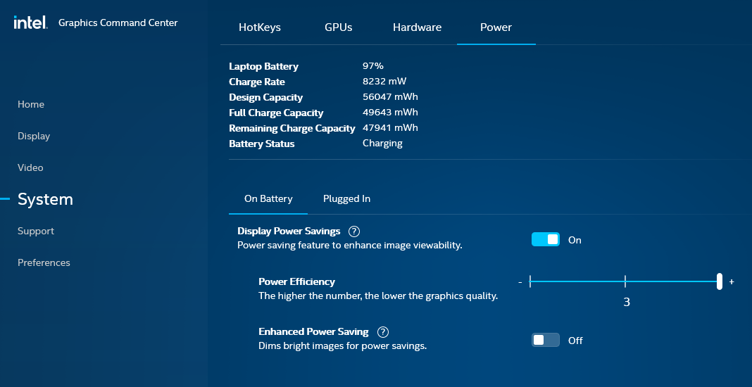

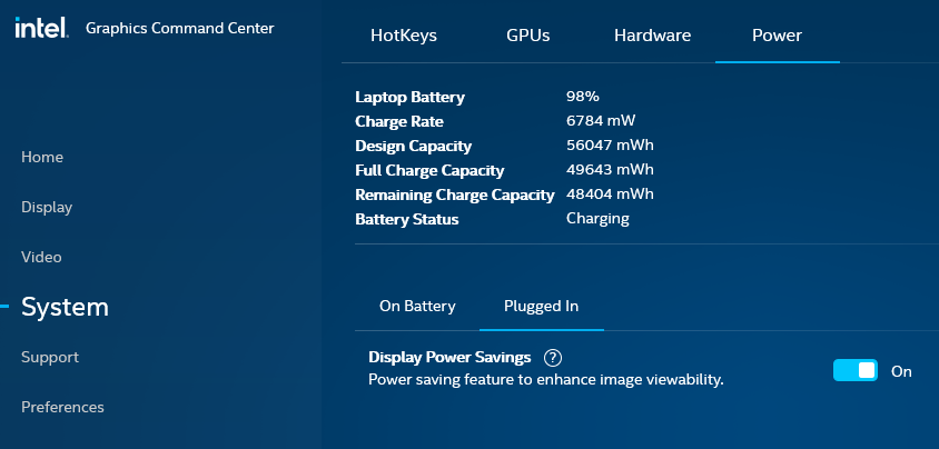

    Thanks for being so patient. I have to say we have to leave out each scenario until we reach the root cause. Since the registry-level rendering bypasses did not resolve the freeze, I think the conflict occcurs at the hardware power management level. A documented culprit for this exact behavior on HP EliteBooks is Panel Self Refresh. This Intel technology attempts to conserve battery life by freezing the display refresh rate when it detects a static desktop image. When you use native Windows drawing tools, the constant micro-updates from the cursor conflict directly with this sleep state, causing the graphics buffer to lock up completely while your operating system continues running normally in the background.
    To eliminate it, we need to disable Panel Self Refresh directly through your hardware control panel. Open your Start menu, launch the Intel Graphics Command Center, and navigate to the System tab located on the left side of the window. Select the Power tab at the top, locate the Panel Self Refresh setting, and toggle it to the off position for both the battery and plugged-in states before restarting your laptop. If your specific Intel driver version hides this setting, or if disabling it fails to stop the freezing, the deadlock is deeply embedded in the generic Intel driver version 32.0.101.8508 you recently installed.
    Generic drivers often lack the proprietary synchronization instructions required by HP's custom motherboard architecture. The most definitive resolution is to revert your system back to the stable, manufacturer-certified graphics driver. Open the Windows Device Manager, expand the Display adapters category, right-click your Intel Graphics device, and access the Properties menu to use the Roll Back Driver function. If that button is disabled because the generic update cleared your previous files, you will need to download and install the specific Intel Video Driver package approved for the EliteBook 640 G11 directly from the official HP support portal or your IT software center to restore proper hardware stability.
