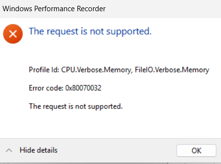

    3. Suggested Diagnostic Tools To see exactly what Windows 11 is doing during that 20-35 minute window, capturing an Event Tracing for Windows (ETW) log is the best approach. I suggest recording the trace by these steps below:
    1. Open the Start menu, type wprui (Windows Performance Recorder), and select Run as administrator.
    2. Click on More options. Then, under "Select additional profiles", expand Resource Analysis and check CPU usage along with File I/O activity. (You can uncheck First level triage).
    3. On the right side, change the Logging mode from Memory to File.
    4. Click Start. (If the software throws an "Access Denied - 0x80070005" error, it proves that your strict WDAC policy completely blocks ETW tracing, and you may need to test this on a machine with Device Guard configured in Audit mode).
    5. Reproduce the slow CreateProcess behavior for about 5 to 8 minutes, then click Save in the WPR window to output the .etl trace file.
