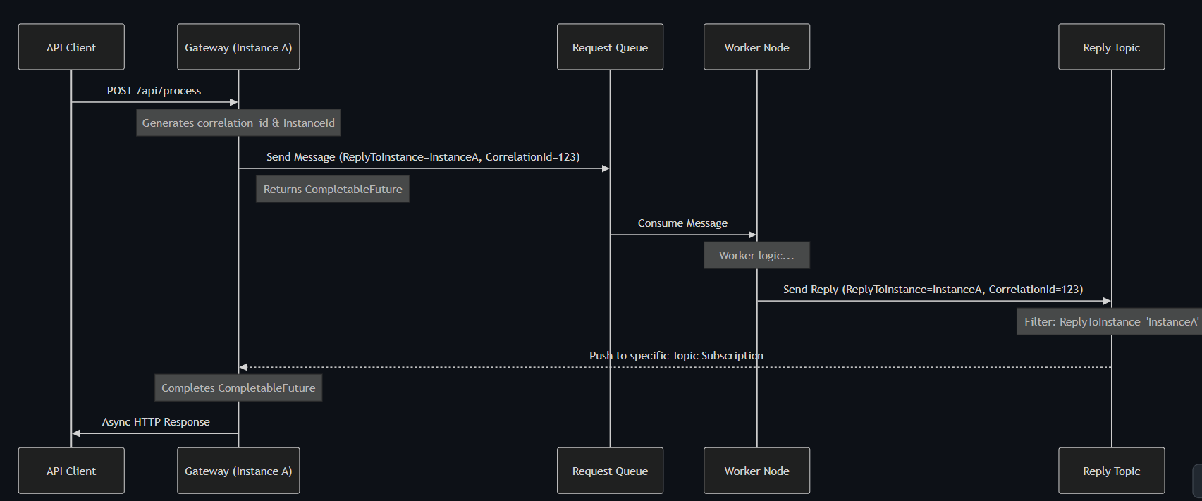

We are building an edge API Gateway to bridge legacy synchronous HTTP clients with long-running, asynchronous AI workers (tasks taking 45+ seconds).
To prevent 504 Gateway Timeouts and thread exhaustion, we are using a Sync-over-Async pattern: the REST controller receives the request, drops it on a Service Bus queue, and waits for a reply from the worker to map back to the HTTP connection.
The standard recommendation is to use Service Bus Sessions to correlate the request to the reply. However, as we scale, we are hitting severe bottlenecks:
Stateful Routing: The Gateway pod must hold a session lock. If that pod crashes, the session is locked and the reply is trapped until timeout.
Standard Tier Limits: A traffic spike easily exhausts the 1,000 concurrent session limit on the Service Bus Standard tier.
Horizontal Scaling: Load balancers distribute incoming requests statelessly, but the session requires stateful tracking to get the reply back to the specific pod holding the open HTTP connection.
Is there a recommended architectural pattern to achieve request-reply correlation over Service Bus at high scale without relying on Sessions, keeping the Gateway pods 100% stateless?

  2. Rakesh Mishra 8,100 Reputation points Microsoft External Staff Moderator
    2026-04-13T18:44:51.1833333+00:00
    Hey Shivam,
    Great question—and nice work teasing out the root of the scaling issue with Sessions. You are completely right that pushing the routing logic down to the broker is the key to achieving stateless gateways, but you need to be very careful with how you implement dynamic subscriptions.
    The flow you described (creating a temporary subscription per request) is actually considered an anti-pattern at scale and will quickly hit Azure Service Bus quotas. Specifically:
    • The 2,000 Limit: Service Bus restricts topics to a maximum of 2,000 subscriptions. A traffic spike of 2k+ concurrent requests will exhaust your namespace quotas and cause complete failure.
    • Control-Plane Latency: Creating and tearing down subscriptions are management API operations. They are heavily rate-limited and far too slow to put on the hot path of an HTTP request.
    • Orphaned Entities: If a pod crashes before deleting its per-request subscription, the subscription leaks. Even with AutoDeleteOnIdle, it takes a minimum of 5 minutes for the broker to clean it up.
    The Recommended Pattern: Per-Pod Temporary Subscriptions + In-Memory Correlation
    To achieve 100% statelessness without hitting limits, you should create a dynamic subscription per Gateway Pod, not per request. Here is the optimized flow:
    1. Gateway Pod Startup (Control Plane)
      • When a Gateway pod spins up, it generates a unique ID (e.g., Pod-42).
      • It creates a single temporary subscription on the shared ReplyTopic with a SQL Filter: ReplyToPod = 'Pod-42'.
      • It configures AutoDeleteOnIdle = 5 minutes so the broker cleans it up if the pod scales down or crashes.
    2. Handling the HTTP Request (Data Plane)
      • The pod receives an HTTP request and generates a CorrelationId (e.g., Req-A1).
      • It registers a TaskCompletionSource (or CompletableFuture) into an in-memory ConcurrentDictionary, keyed by the CorrelationId.
      • It sends the work message to the worker queue, stamping both CorrelationId = 'Req-A1' and ReplyToPod = 'Pod-42'.
    3. Worker Processing
      • The AI worker does its 45+ second job and publishes the reply to the ReplyTopic, passing along the same CorrelationId and ReplyToPod properties.
    4. Broker-Driven Fan-in
      • Service Bus evaluates the SQL filter and pushes the message strictly to Pod-42's subscription.
      • The message pump on Pod-42 reads the message, extracts the CorrelationId, pulls the corresponding Task from the ConcurrentDictionary, and completes it—returning the HTTP response.
    Why this is the ultimate scaling fix:
    • Zero Hot-Path Latency: You execute zero control-plane operations during a request.
    • Massive Scale: If you scale to 500 gateway pods, you only have 500 subscriptions on the topic—well below the 2,000 hard limit.
    • Stateless horizontally: Standard load balancers can route the incoming HTTP request to any pod, and the Service Bus handles routing the reply back to the exact pod holding that specific TCP connection.
    (Note: Since your AI workers take 45+ seconds, ensure your edge Load Balancers/Ingress controllers have their idle timeout increased to 60s+, otherwise the client will receive a 504 Gateway Timeout before the Service Bus reply even makes it back to the pod! If you cross the 60s boundary, you may need to abandon Sync-over-Async entirely and adopt an Asynchronous HTTP 202 Polling pattern).
    Hope this helps you unblock your scale-out safely and let me know in comments if it works.
