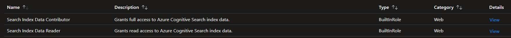

Getting this error message in the UI.
Error loading knowledge basesFailed to fetch knowledge bases for connection mycontososearchxnpcrk.
Note - I have granted Search Index Data Reader, Search index data contributor and Search Service contributor to foundry project managed identitiy as well as to managed identity of foundry resource itself.
Still no success. Any ideas what I am missing here ?
