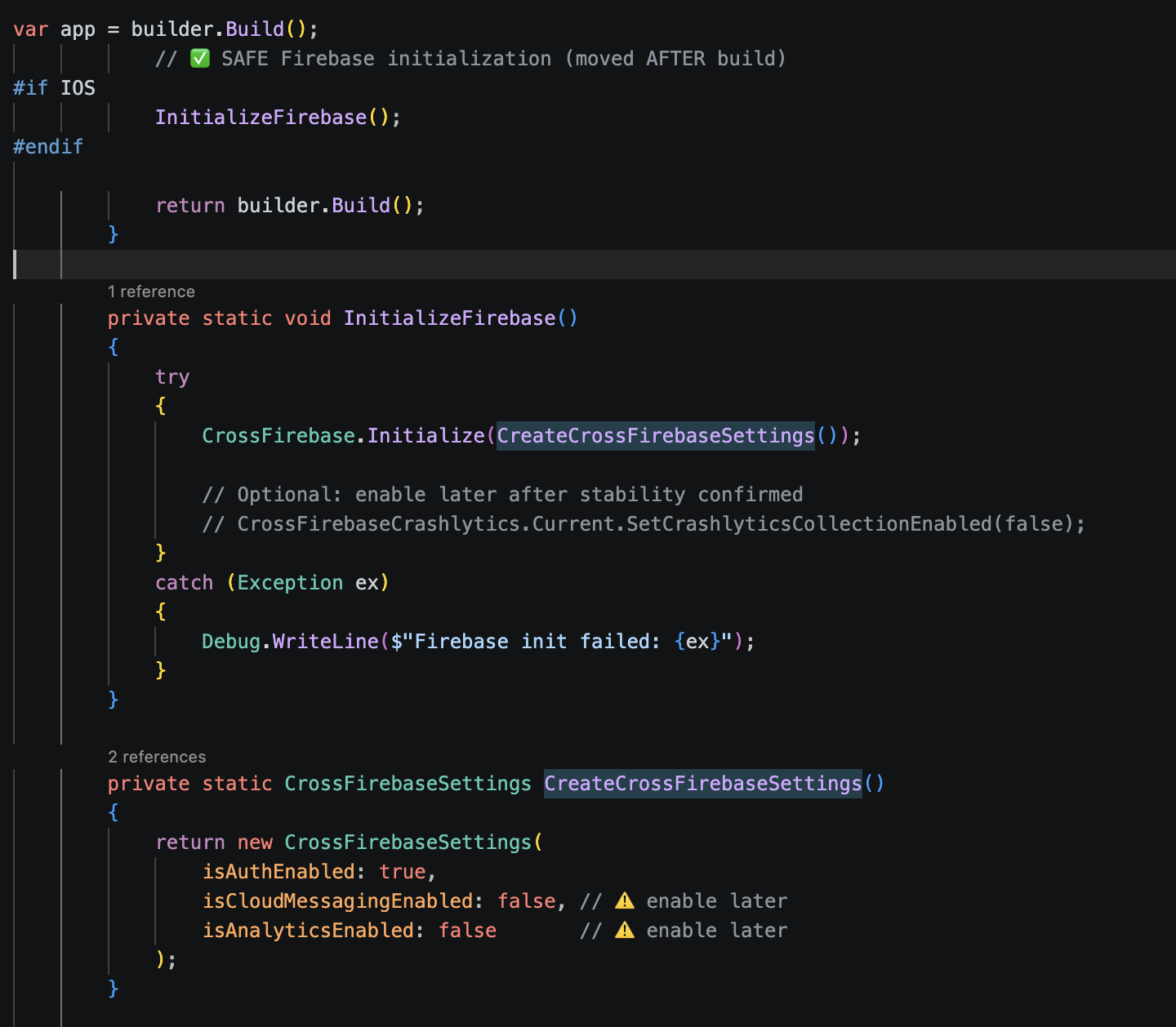

While analyzing the logs I didn't see anything unusual.
