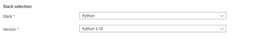

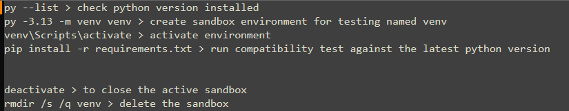

I just want to confirm if my way of testing is enough to confirm that the app service we use is ok to upgrade to the latest python version:
I dont have python knowledge or azure cloud I am just learning through browsing the internet.
Currently, I cannot test it in the azure since we do not have an instance of staging, dev or deployment slot where I can test this before updating the python version of our web app in production on Azure.
I am open for any recommendation or tips where I can assure the compatibility of the current service to the new python version.
It is currently on 3.10 and im planning to upgrade it to 3.11 atleast.
Thank you very much!

    1. Confirm the target version is supported in App Service
      Use Azure CLI to list supported Python runtimes for Linux:
         az webapp list-runtimes --os linux | grep PYTHON
      This shows which exact PYTHON|x.y values are available for your web app.
    2. Match local tests to the Azure runtime
      When creating the local virtual environment, use the same major/minor version that App Service will use (for example, 3.11.x). Install all dependencies with pip install -r requirements.txt and run the application’s own tests or a basic startup test (for example, run the web app locally) to ensure imports and startup succeed.

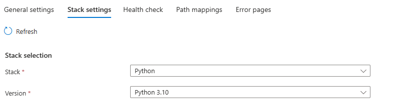

    3. Plan the change in App Service
      For Linux apps, the Python version is controlled by linuxFxVersion. You can view or set it with Azure CLI:
         az webapp config show \
           --resource-group <resource-group-name> \
           --name <app-name> \
           --query linuxFxVersion
         az webapp config set \
           --name <app-name> \
           --linux-fx-version "PYTHON|3.11"
      Replace names as appropriate. This aligns the app with the Python version you tested locally.
