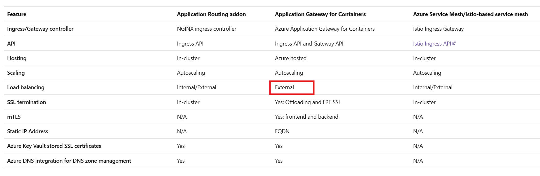

We are currently evaluating the use of Application Gateway for Containers within our AKS environment.
Based on our current understanding, the service appears to support only external load balancing scenarios at this time. We would like to confirm whether internal load balancer (private endpoint / internal exposure) support is on the product roadmap.

    You're correct Application Gateway for container currently supports external load balancing only. It provisions public FQDN frontends and does not support private IPs or internal frontends at this time.
    There’s no public roadmap or timeline available yet for internal load-balancer support. The best place to watch for future updates is the Azure updates page.

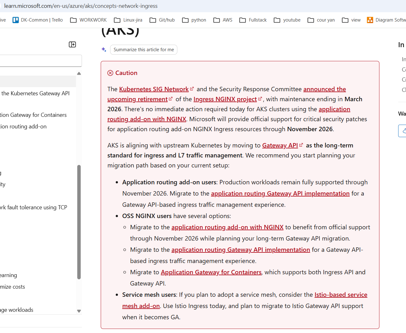

    The available documentation describes Application Gateway for Containers as an Azure‑hosted, layer‑7 ingress/load balancer for AKS that exposes workloads via frontends associated with an anycast IP, and it explicitly calls out support for HTTP/HTTPS ingress using Ingress and Gateway API resources. However, the documentation in the provided context does not state support for an internal‑only (private) mode, nor does it provide a roadmap or timelines for such a feature.
    Because no roadmap or timeline information is published in the referenced documentation, there is no supported statement available here about:
    • Planned support for internal load balancer / private endpoint exposure
    • Expected delivery timelines
    For internal‑only ingress scenarios today, the AKS networking guidance in the context recommends using either:
    • A layer‑4 Load Balancer Service for non‑HTTP traffic, or
    • An ingress controller for HTTP‑like traffic. Managed options called out include:
      • The application routing add‑on with managed ingress‑nginx
      • Istio ingress gateway
      • Azure Application Gateway for Containers (recommended managed ingress option overall)
    Since internal/private mode for Application Gateway for Containers is not documented in the provided material, the documented alternatives for internal‑only access are:
    1. Use a Kubernetes LoadBalancer Service with an internal Azure Load Balancer for private, in‑VNet access to services.
    2. Use another ingress controller option that supports internal exposure as documented in AKS application networking guidance (for example, managed NGINX via the application routing add‑on or Istio ingress gateway) while planning long‑term migration to Gateway API–based solutions.
