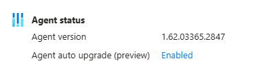

Can we enable the auto upgrade the azure arc agent if we use version 1.51 ?
If the agent already set to auto update then how often the schedule will run to check if there any new version or not.
