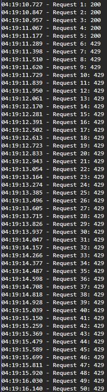

Hello, I am facing an issue with Token bucket rate limiting, for testing purpose i set the limit to 5 and replenishment amount to 3 every 2 minutes and created partition based on userId. i created a small code which calls an api ( i have added the per user policy in its controller) in a loop over 50 times :
var response = await client.GetAsync("api/Account/all");
Console.WriteLine($"Request {i}: {(int)response.StatusCode}");
await Task.Delay(100);}
the first 5 request works as expected returning back 200 and the 6th one gets 429, but sometime after betweeen the 20th and 30th request one of the request gets 200 and the rest is 429, if it was the token getting replenished then the next two request should also get 200 right ? i cannot seem to understand this behaviour, there is also one other weird behavior when i set the time to 1 minute then the 6th request is 200 and from the 7th it gets 429.
I am running the web api locally on my system and i have verified whether the userId is being populated each time, it does. I am Lost, any help is much appreciated.

    With your token bucket configuration:
    • TokenLimit = 5
    • TokensPerPeriod = 3
    • ReplenishmentPeriod = 2 minutes (or 1 minute in your other test)
    …and your test loop of 50 requests with 100ms between requests, the entire run only takes around 5 seconds. That’s much shorter than either replenishment period, so no tokens should be replenished during this test.
    This means that any requests after the first 5 returning 200 are not caused by normal token replenishment. Likely causes include:
    • The requests may not all be using the same authenticated identity.
    • The tested endpoint may not always be hitting the same rate-limited path or policy.
    • Another client or request source may be affecting what you observe.
    If you’ve verified that the same userId is used for every request, it would be helpful to log the actual partition key and confirm that the same policy is applied on every request. This can help identify if some requests are bypassing the per-user limiter.
