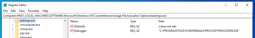

    @GW VS When the Process Explorer option to replace task manager is set Process explorer uses Window's Image File Execution Options registry key. This key is located at HKLM\Software\Microsoft\Windows NT\CurrentVersion\Image File Execution Options. It is a machine-wide setting and elevated privileges as an Administrator are needed to write to it.
    For example, on my Win10 22H2 system the registry change made by Process Explorer looks like this -
    perplace Of course, the path to the Process Explorer executable depends on where you saved it after extracting it from the distribution zip file.

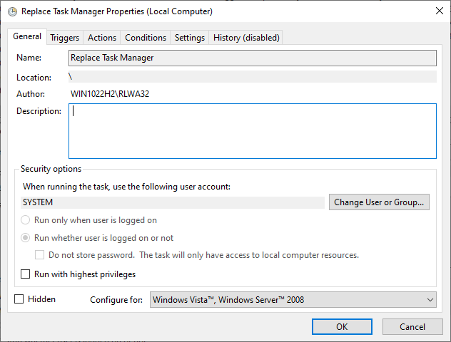

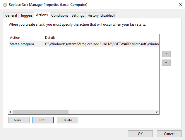

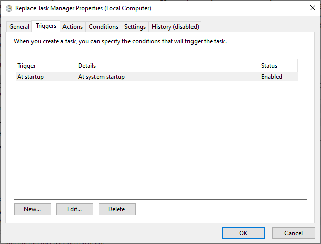

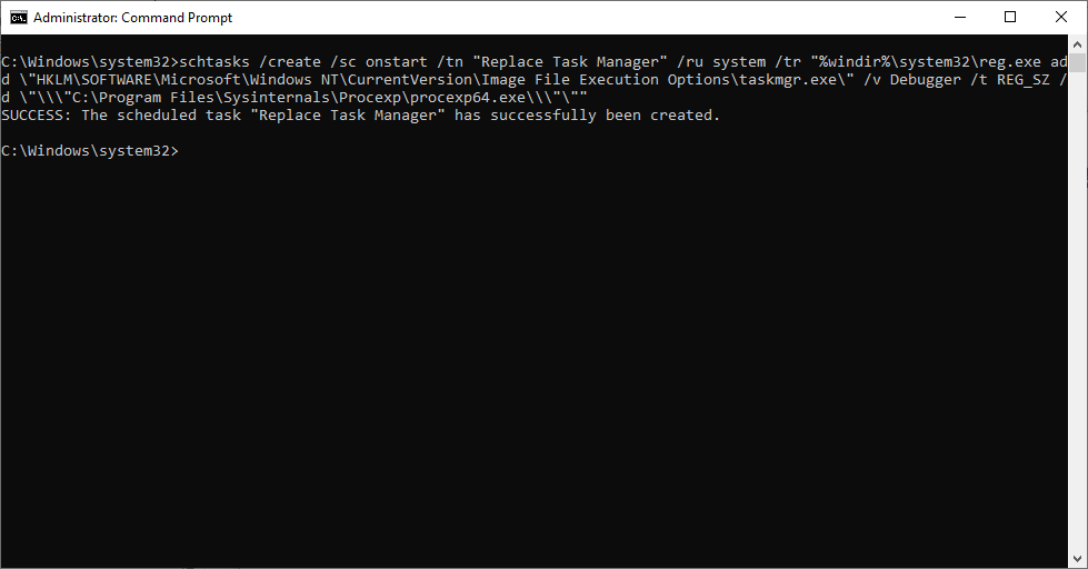

    You may be able to achieve persistence by using a scheduled task to recreate the Process Explorer registry data when your system starts or when you log on. The following example XML when imported into Task Scheduler creates a scheduled task that runs when the system starts up and creates/recreates the Process Explorer data

      <Triggers>
        <BootTrigger>
          <Enabled>true</Enabled>
        </BootTrigger>
      </Triggers>

          <Command>%windir%\system32\reg.exe</Command>
          <Arguments>add "HKLM\SOFTWARE\Microsoft\Windows NT\CurrentVersion\Image File Execution Options\taskmgr.exe" /v Debugger /t REG_SZ /d "\"C:\Program Files\Sysinternals\Procexp\procexp64.exe\""</Arguments>
        </Exec>
      </Actions>
    </Task>
    You would need to edit the task for the path to Process Explorer on your own system.
