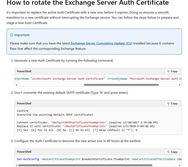

    3/ Review the authentication certificate
    Another potential cause may be an issue with the authentication certificate. You can review the current certificate details by running:
    (Get-AuthConfig).CurrentCertificateThumbprint | Get-ExchangeCertificate | Format-List Subject, Thumbprint, NotAfter, NotBefore
    If the certificate is missing or has expired, please refer to the following Microsoft documentation for guidance on creating a new authentication certificate: Maintain the Exchange server OAuth certificate | Microsoft Learn
