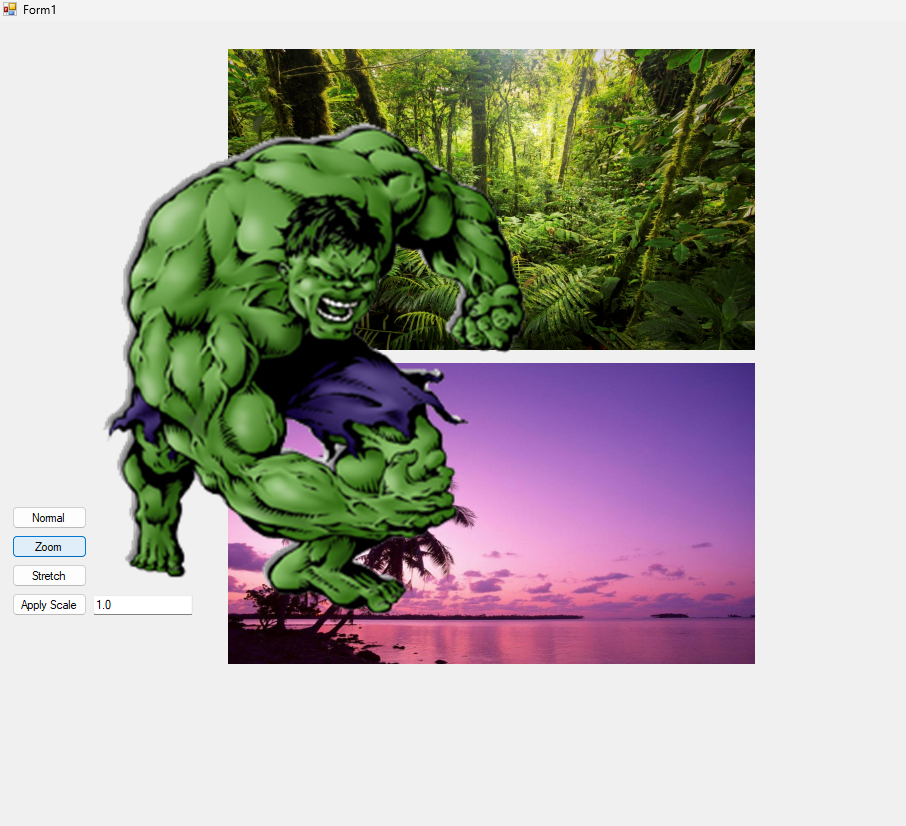

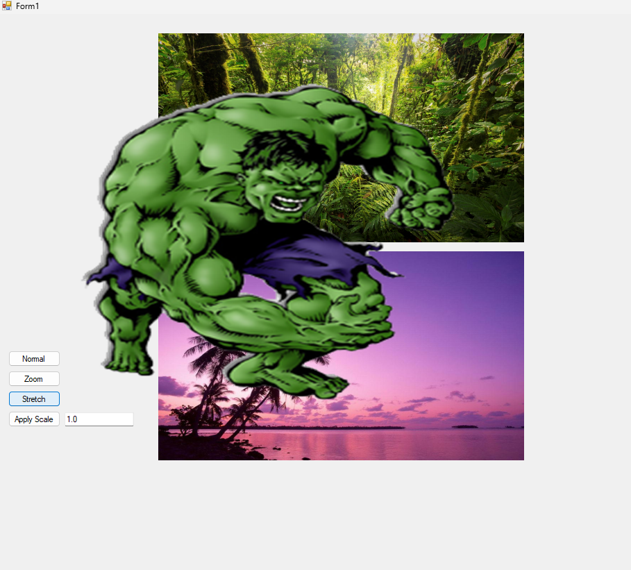

        Stretch = 1
        Zoom = 2

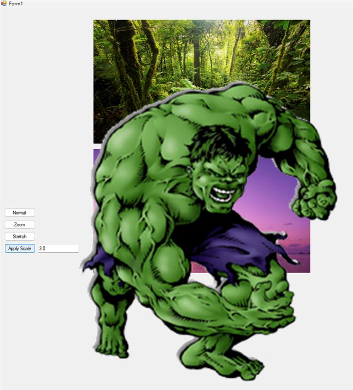

    TransparentControl1.ImageLayoutMode = TransparentControl.TransparentImageLayout.Scale
    This seems to behave closer to what you described. I would not say this is the definitive fix, but it may be a useful workaround if you want TransparentControl to behave more like a PictureBox with layout-style options.

    Zooming
    Stretching
    Scaling
