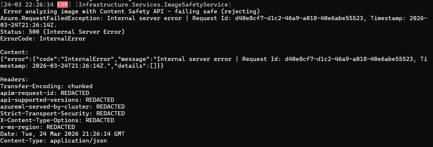

I've deployed an Azure Content Safety ressource on my rg-group in Central Sweden region, and it worked perfectly until earlier today when I suddenly experienced an internal error from Azure, and I haven't been able find out any additional information on this issue or why it's occurringUser's image

    The error shown indicates that Azure AI Content Safety image analysis requests are reaching the service successfully but are failing during internal processing. The response returned is HTTP 500 (InternalServerError) with error code InternalError, along with a request ID and timestamp.
    This is happening as Azure AI Content Safety is encountering an internal processing failure while analyzing images, resulting in a fail‑safe rejection of the request. The request is accepted, authenticated, and routed correctly, but an internal dependency fails before moderation results can be produced.

    The InternalError with HTTP 500 is a server-side issue in Azure AI Content Safety, not a problem with the request payload or your resource configuration.
