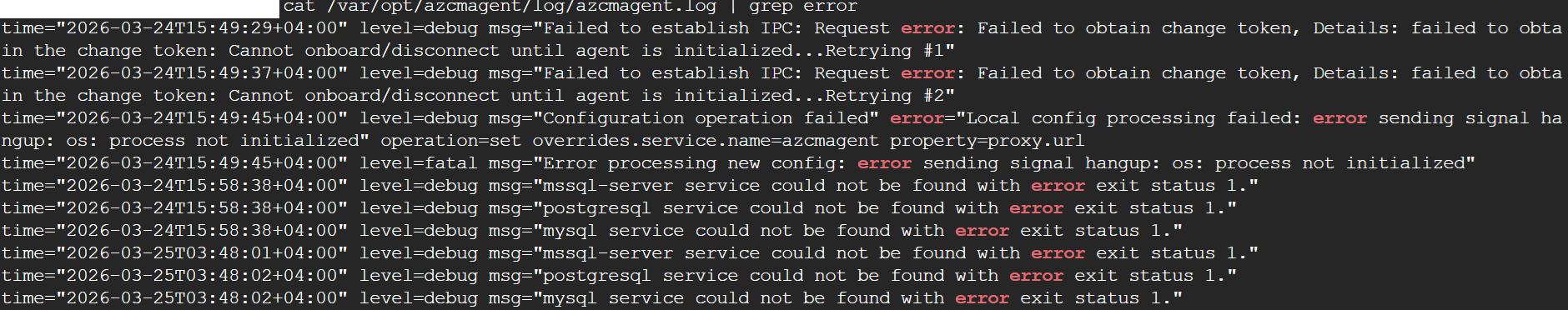

I’m currently facing an issue while configuring Azure Arc on a Linux server. The agent installation completes successfully, but the configuration step fails.
I have attempted both approaches:
  • The script generated from the Azure Arc portal
  • The manual installation and configuration method
However, the outcome remains the same in both cases. This issue is occurring on one specific server.
The error received is: AZCM0101: Command Execution Error, and the Arc proxy service remains stuck in an activating state. This persists even after deleting the localconfig.json file and retrying the configuration.
Could you please assist in identifying the root cause and suggest a resolution?
