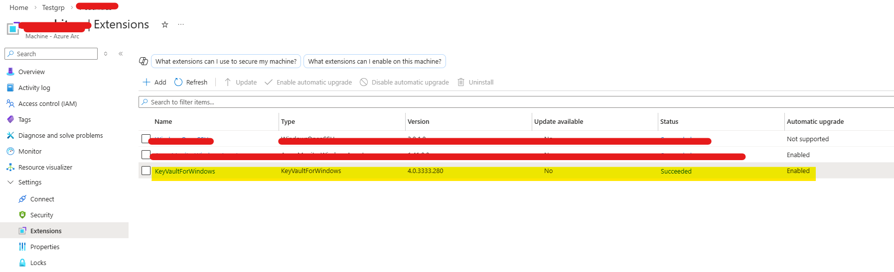

Thomas Zook • 25 Reputation points
2026-03-24T17:13:42.3466667+00:00 Hello @Suchitra Suregaunkar
The indication in the portal and on the server showed that the version of the extension was 4.0.333.280, but for the sake of troubleshooting, I uninstalled the extension and re-installed it while specifying the type handler version to be 4.0.
The issue continues to occur, but I did find further logging in C:\ProgramData\GuestConfig\extension_logs\Microsoft.Azure.KeyVault.KeyVaultForWindows and found the following entry:
