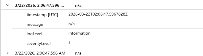

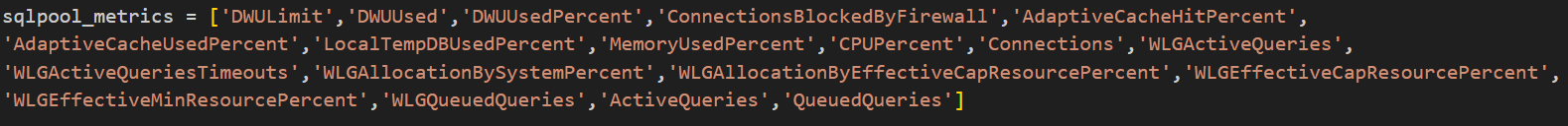

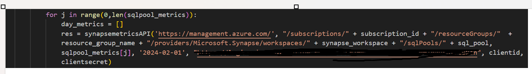

I have python codes in function app to fetch all the azure metrics data of Dedicated SQL Pool. I am able to get the data for all the metrices except Connections metrics. The code is generating empty files for the same. I added logging.info in the code to check the response and found out that the response is coming as "n/a" in the logs. Below is the screenshot.

    Here are the most common reasons & things to try:
    1. Verify you’re targeting the right resource and metric namespace
      • For a dedicated SQL Pool under Synapse, the resourceId should look like: /subscriptions/{sub}/resourceGroups/{rg}/providers/Microsoft.Synapse/workspaces/{ws}/sqlPools/{pool}
      • If you accidentally point at the “Microsoft.Sql/servers/databases” namespace (or the Function App itself), you won’t get the dedicated pool’s Connections metric.
      • Quick test: call the Metric Definitions API in your Function and log the list of metric names to see if “Connections” actually shows up.
    2. Check your API version / SDK version
      • The Azure Monitor REST API version you use can change which metrics are exposed. Locally you might have v1.0.0 of the Python SDK (or an explicit api_version=2018-01-01) but your Function App’s deployed package could be on an older library that defaults to v2017.
      • Make sure in your Function you either specify api_version=2018-01-01 (or later) when you call metrics.list() or upgrade your azure-mgmt-monitor package to the same version you have locally.

    4. Capture the raw HTTP response
      • Add a little debug around your HTTP call (or SDK call) that dumps the full JSON response from /metrics. That will tell you definitively whether the Connections metric “exists” but just has no data, or if the service didn’t even list it.
