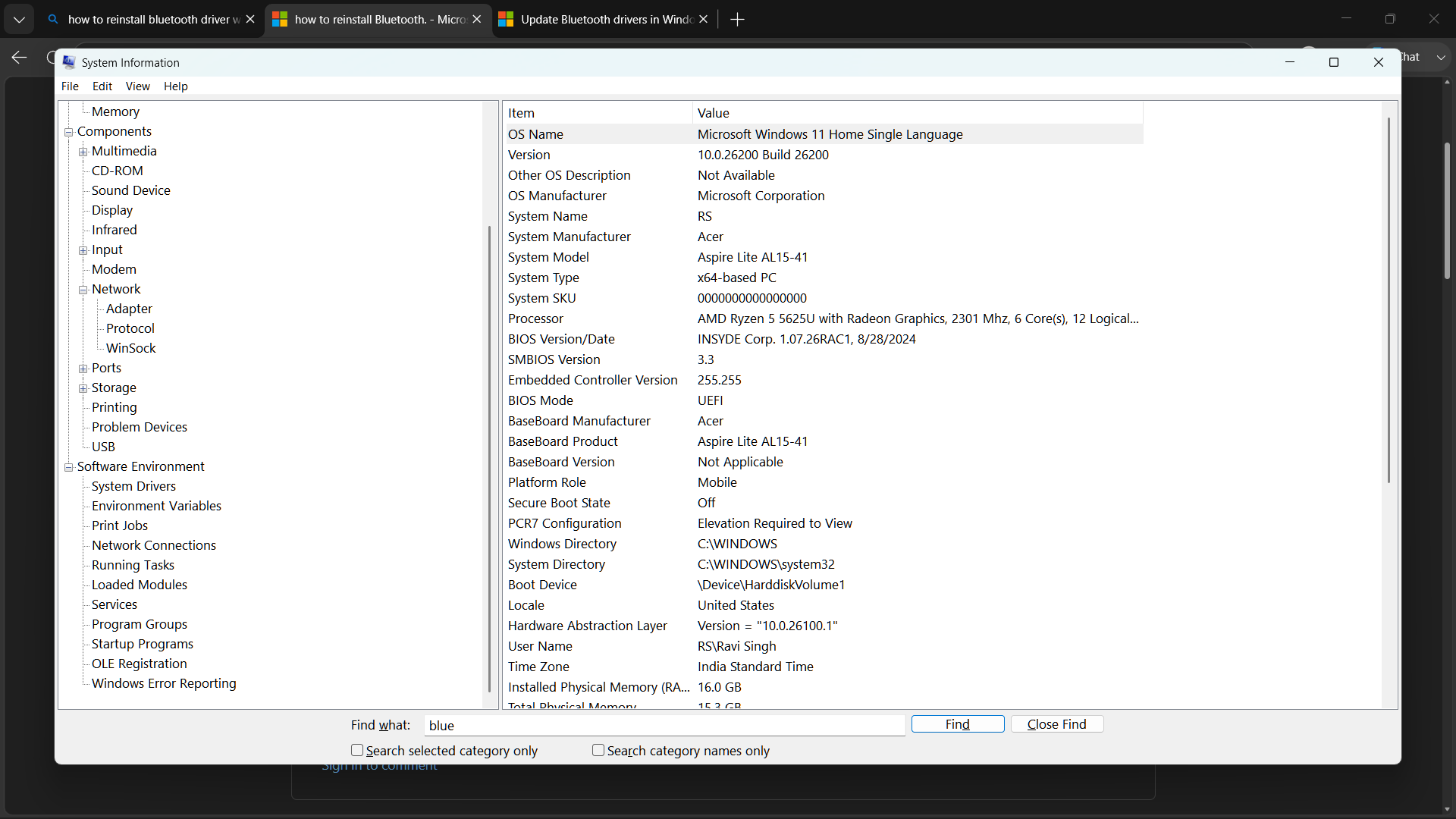

    If not, Can you share with me two screenshots please?
    1. Go to Device Manager > Network Adapters, I would like to see what's listed.
    2. Please type msinfo32.exe in the search on the taskbar and hit enter, then share a screenshot of the pop up.
    Thanks!
