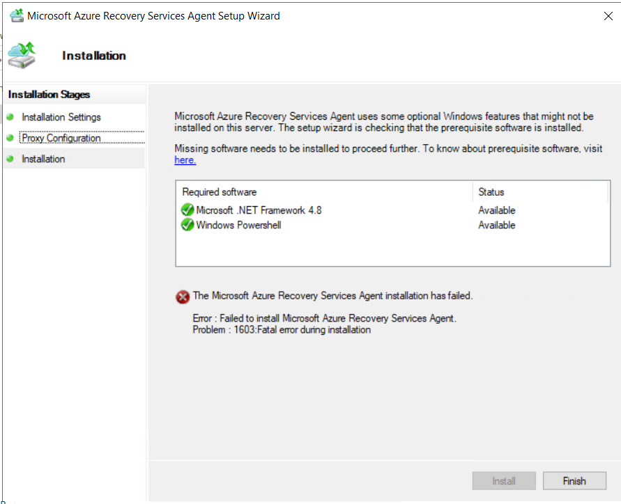

Microsoft azure recovery services agent installation getting failed
Lewies Thomas 0 Reputation points
2026-03-21T19:47:36.6133333+00:00
I am having the issue which installing the MARS agent. can someone help me and provide me with a solution to rectify this issue.User's image

    It looks like you’re running into the classic MSI 1603 fatal-error when installing the Microsoft Azure Recovery Services (MARS) agent. Here’s a checklist of things to try that usually clear this up:

    Error 1603 is a generic Windows Installer fatal error. For Microsoft Azure Recovery Services (MARS) Agent, common causes and fixes in the provided context are:
