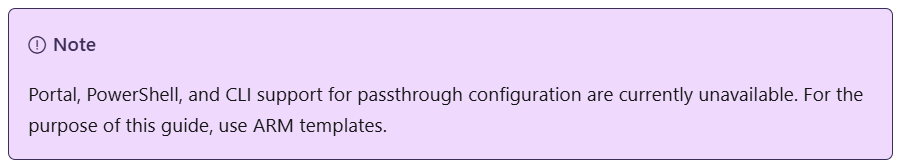

    You're not doing anything wrong. This is a known current limitation with mTLS passthrough mode on Application Gateway. The feature works perfectly when first deployed via the ARM template (as you did), but the Azure Portal, PowerShell, and CLI don't fully support the verifyClientAuthMode: "Passthrough" setting yet. That's why any update triggers the "SslProfile must specify either SslPolicy or TrustedClientCertificates" error. Adding either of those properties unfortunately switches the gateway out of true passthrough.
    The intended (and fully supported) way to work with passthrough today is to manage the Application Gateway as infrastructure-as-code using ARM templates (or Bicep) with API version 2025-03-01. Any future changes scaling, rules, backend updates, etc. should be made by editing and redeploying the template in incremental mode. This keeps your passthrough configuration intact.
    The Azure Portal, PowerShell, and CLI don't yet understand the verifyClientAuthMode: "Passthrough" setting on the SSL profile, so any update attempt from those tools triggers the validation error you're seeing: "SslProfile must specify either SslPolicy or TrustedClientCertificates."

    ARM/Bicep is the official path for both creation and updates.User's image
