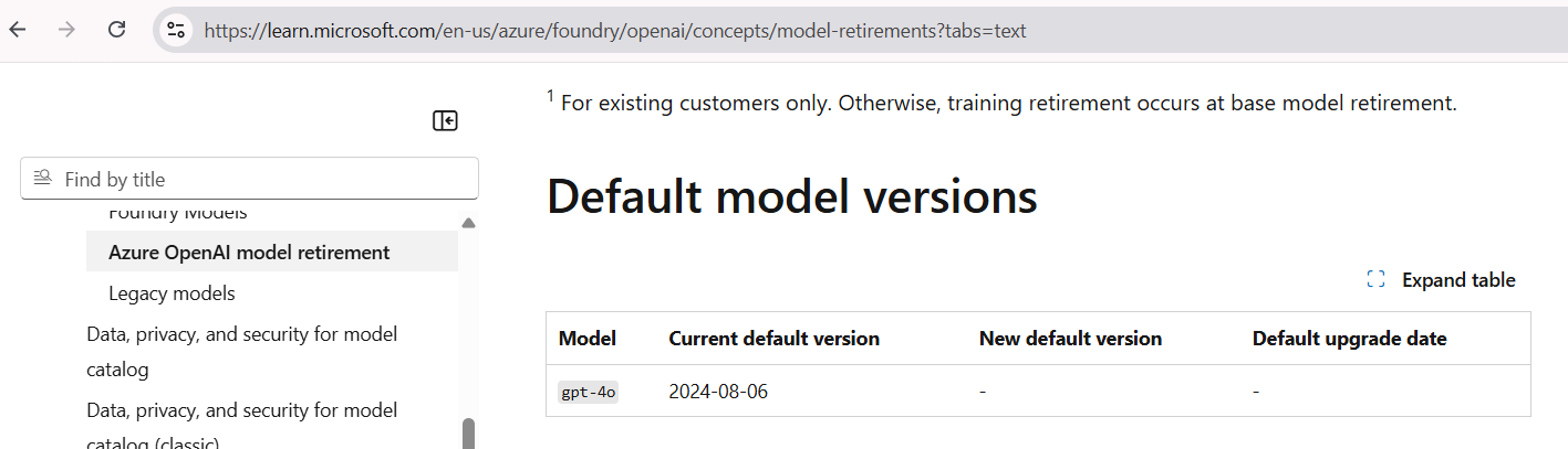

GPT-4o is scheduled for retirement on March 31, 2026. I currently have a deployment in Azure OpenAI Foundry using GPT-4o (model version: 2024-08-06), with the version upgrade policy set to “Once a new default version is available”

    2. How to identify the default version?
    Model deprecations & retirements documentation (shows current + next default versions)
    Also check via Azure Portal (deployment UI / model dropdown)
    CLI:
    az cognitiveservices account deployment list ...
    REST API (/deployments)

    Default versions are published and can also be checked per deployment:
    • Documentation publishes a Default model versions table. For example, it shows gpt-4o current default version 2024-08-06 and notes when defaults change for other models.
    • In Azure Government, a separate table shows that gpt-4o default can differ by cloud (for example, 2024-11-20 as default in Azure Government vs 2024-08-06 in public cloud), illustrating that default is centrally defined and can change over time.
