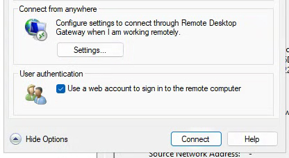

Hello, I have a strange issue on connecting using AAD login to the RDP server that has a system-assigned managed identity and the AADLogin extension installed successfully. The user has the Virtual Machine Local User Login role, using mstsc.exe and select the "use a web account to sign in to the remote computer" checkbox, the user is also member on the server of the group: Hybrid agent extension applications. I use the logon like this: ******@mydomain.xx and I get the following error and a logon loop that always goes back to the logon page from ms365: Logon failure. Status: 0xC0000022 Correlation ID: an id

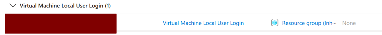

    7. Check Azure RBAC role assignment: • Verify that the user is assigned the built-in “Virtual Machine User Login” (or “Virtual Machine Administrator Login” if you need admin rights) role under your Arc-enabled server’s Access control (IAM).
      • The “Virtual Machine Local User Login” role you mentioned isn’t one of the documented built-in roles for AADLoginForWindows, so please double-check the exact role name.
