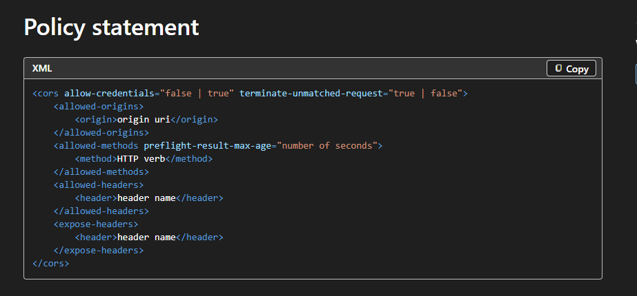

    • Remove the x-api-key, having both that and Ocp-Apim-Subscription-Key can cause issues since APIM only needs the subscription key.
    • Also, add a CORS policy to your APIM MCP server without it Foundry's requests can get blocked silently because they're coming from a different domain.
      • APIM → APIs → your MCP server → Policies and add a basic inbound CORS policy allowing all origins. You can tighten it down to specific origins once it's working.
      https://learn.microsoft.com/en-us/azure/api-management/cors-policy
      The block below can be added to alow Foundry's specific domain
