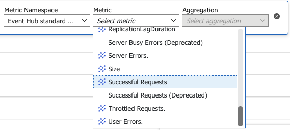

  1. Petr Zuzanov 0 Reputation points
    2026-04-05T13:14:19.61+00:00
    @Smaran Thoomu there is no metric "Throughput Units"User's image
