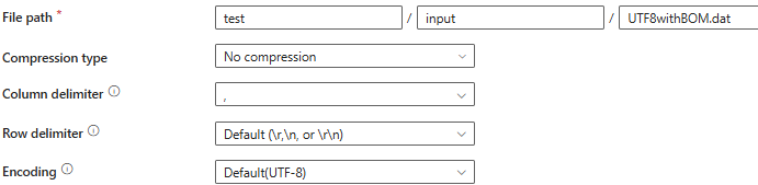

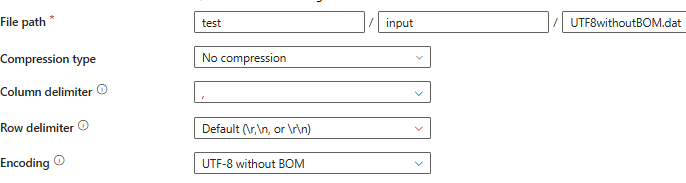

I made dataset like this and used it in dataflow,it worked.it also worked when i use a file which is utf8withbom.meanwhile,when the dataset like the picture below, the dataflow failed.1
3
The result is different from that of the article,so i make this question,thankyou!

    Hey Li, I ran the same experiment you did and here’s what I found:
    1. The “UTF-8 without BOM” option in a Delimited Text dataset is a Copy Activity feature—Mapping Data Flows today don’t honor that explicit setting.
    2. Under the covers, Data Flows only support the Default (UTF-8) encoding (which behaves as no-BOM UTF-8) and the UTF-8 with BOM choice. If you explicitly switch your dataset to “UTF-8 without BOM,” the data flow engine will reject it with that error you saw.
    3. In practice, leaving your dataset encoding on Default (UTF-8) lets the data flow read both BOM-less and BOM-prefixed files without complaint.
    Workarounds:
    • Keep your Data Flow source dataset set to Default (UTF-8).
    • If you really need to strip or add a BOM, do a small Copy Activity or Data Flow Derived Column that removes/inserts the first three bytes before your main business flow.
