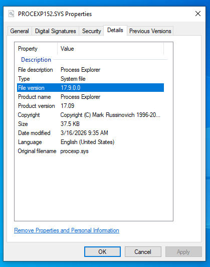

    @Narendra kala The version information for the PROCEXP152.SYS driver associated with version 17.1 of Process Explorer is as shown here -
    Procexpdriver

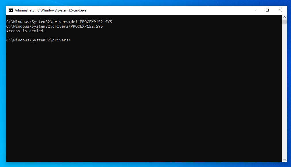

    If the PROCEXP152.SYS driver is not present on the system Process Explorer will install it when it is run with elevated privileges as an Administrator. Consequently, the driver is loaded by the system and cannot be replaced by a newer version without restarting the system. For example, the driver cannot be deleted by an Administrator as shown here -
    procexpdel
    Once the driver has been loaded by a running system installing the most current version of Process Explorer and running it with elevated privileges as an Administrator will NOT update the driver unless the system has been restarted.
