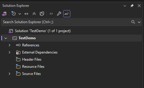

    I will demonstrate it to make it clear for you:
    First, I created a project.

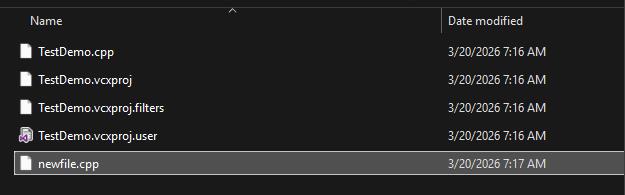

    As you can see, there’s nothing in it. In the project’s folder, I created a new .cpp file.

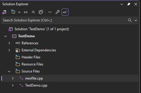

    Then, I returned to the Solution Explorer window and right-clicked the project solution -> Add -> Existing Item….
    enter image description here
    You can see that the file was added successfully. Give it a try.
    I am using Visual Studio 2026. If there are any problems, I would suggest repairing your current version of VS or installing a fresh copy of Visual Studio 2026.
