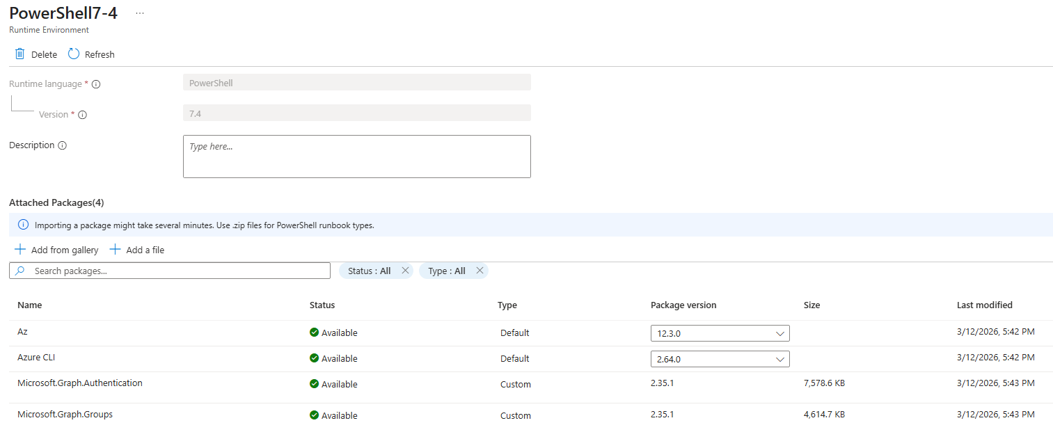

    Here are the steps to fix:
    Upgrade to PowerShell 7.4:

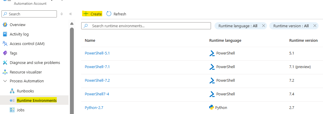

    1. Go to the Azure portal and select your Automation account.
    2. Under Process Automation, select Runtime Environments. If you don't find Runtime Environments in the list,
    1. Select Try Runtime environment experience in the Overview page to switch to the new portal interface.
    2. Select Create to create a new PowerShell 7.4 Runtime.
    3. On the Basics tab, provide the following details:
    4. Enter Name for the Runtime environment. It must begin with alphabet and can contain only alphabets, numbers, underscores, and dashes. From the Language dropdown list, select PowerShell.
    5. In Runtime version for scripting language, select 7.4 and Enter appropriate Description.
    6. On the Packages tab, in the Package version dropdown list, you would see default Az and Azure CLI packages already present.
    7. Select +Add from gallery to add your packages Microsoft.Graph.Authentication 2.35.1 and Microsoft.graph.Groups 2.35.1 from gallery and select Next.
    1. On the Review + create tab, review the entries and select Create.
    Update PowerShell Runbook in Azure Runtime Environment - Azure Automation | Microsoft Learn
    Now create a Runbook using the PowerShell version 7.4 and add your script then run your Runbook
