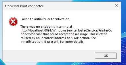

I installed Universal Print Connector 2.4.9459.590 on a Windows Server 2025 Standard server. The Print Connector Service keeps stopping and restarting. When the service starts, I am briefly able to log in, but it stops again shortly after.

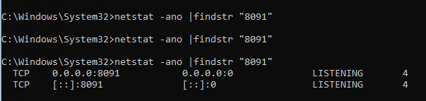

I verified that the required port is not already in use. Could this be an issue with this version of the connector, or is there anything else I should check or configure?
Thank you.
netstat -ano |findstr "8091"
when I run the program I get this

    I have changed the ports 8095 and that did not do anything same

    The connector service repeatedly stopping and the “Failed to initialize authentication. There was no endpoint listening…” dialog indicate a Universal Print Connector service issue rather than a port‑8091 conflict.

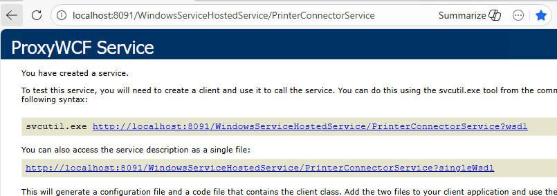

    6. If the WCF endpoint conflict reappears If at any point another process starts using port 8091 and the connector shows a “wcf endpoint is not listening” error again, change the connector port:
      1. Identify a free port (for example, 8095).
      2. In an elevated PowerShell window run:
              net stop "print connector service"
              net stop printconnectorupdatersvc
              reg add HKEY_LOCAL_MACHINE\SOFTWARE\Microsoft\UniversalPrint\Connector /v ServicePort /d 8095 /F
              net start "print connector service"
              net start printconnectorupdatersvc
      3. Verify the service is listening on the new port by browsing to: http://localhost:8095/WindowsServiceHostedService/PrinterConnectorService and confirming the ProxyWCF Service page loads.
