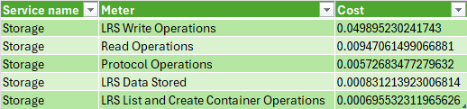

    These were the costs of a week I had in GPv1:

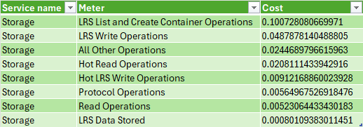

    These are the ones I have now in GPv2, again in a week:User's image
    The item "LRS List and Create Container Operations" accounts for almost all of the cost increase.
    Is there a way, perhaps by changing some settings in the function app, the storage, or the host.json file, to contain these costs?
