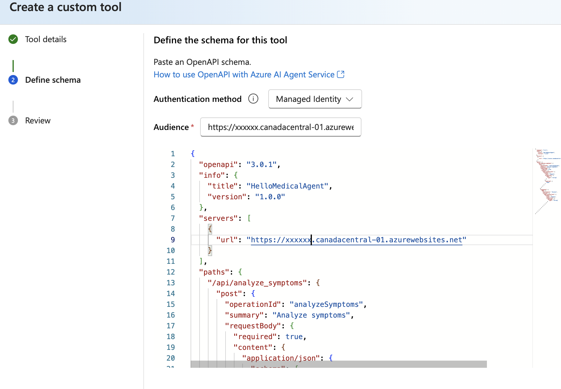

I am facing issue while trying to connect function app with agent using openapi
Surya Chauhan 0 Reputation points
2026-03-07T12:15:37.09+00:00
The schema I have used is
"openapi": "3.0.1",
"info": {
"title": "HelloMedicalAgent",
"version": "1.0.0"
"servers": [
"url": "https://xxxx.canadacentral-01.azurewebsites.net"
"paths": {
"/api/analyze_symptoms": {
"post": {
"operationId": "analyzeSymptoms",
"summary": "Analyze symptoms",
"requestBody": {
"required": true,
"content": {
"application/json": {
"schema": {
"type": "object",
"properties": {
"name": {
"type": "string"
"required": [
"name"
"responses": {
"200": {
"description": "Success",
"content": {
"schema": {
"type": "object",
"properties": {
"message": {
"type": "string"
I am using managed identity as authentication and my function app code is

When I add to my agent as tool I am getting below error
type: "openapi"
function: {
arguments: "{"name":"John"}"
output: "content_type='system_error' name='ValueError' text="Encountered exception: <class 'ValueError'>.""

    The integration is correctly configured. The failure is caused by an unsupported token audience value in the agent’s managed identity configuration, preventing authentication from reaching the function app.
    The expected flow is that the
    1. Agent acquires a Managed Identity access token
    2. Token is sent to the Function App
    3. Function App validates the token via Entra ID
    4. Function code executes and returns a response

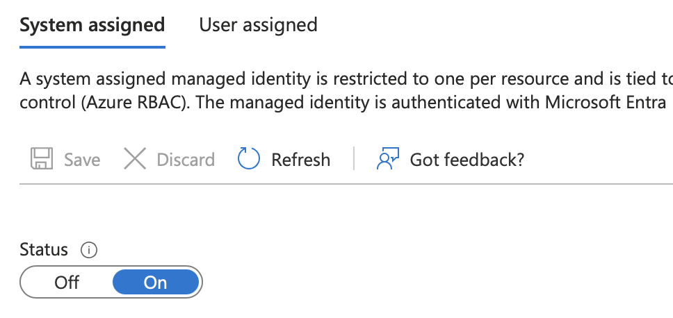

    However, the Agent tool call fails with a system_error / ValueError, while the Function App shows zero invocations.
    From the provided information and screenshots , we can see that the Invocation count = 0 .This confirms the Function code is never executed. The failure occurs before the request reaches the function app runtime at the authentication layer.

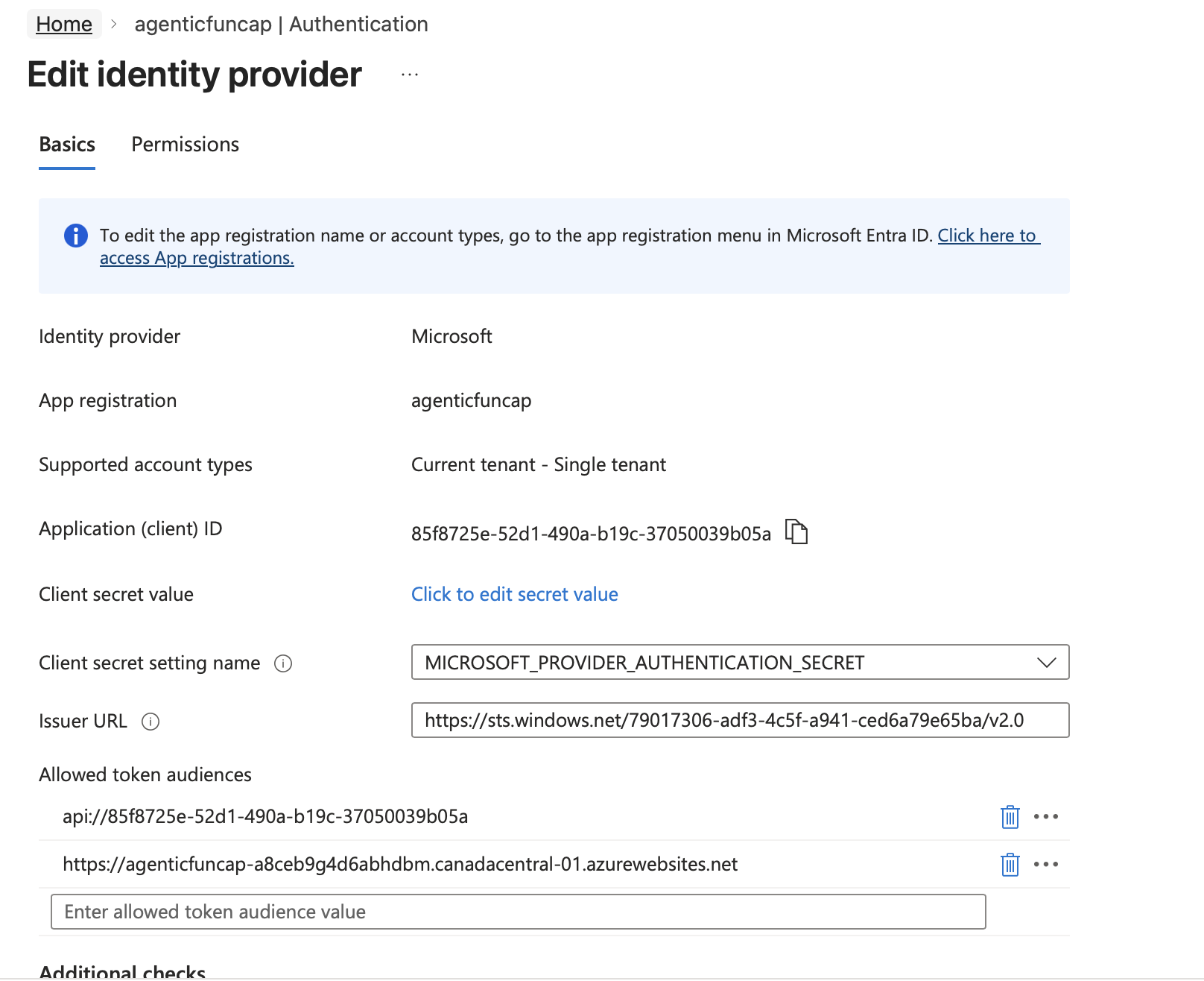

    The identified root cause is that the Agent’s Managed Identity is requesting an access token using an unsupported audience value for Azure Function App authentication.While the function app allows multiple token audiences, Azure AI Agent + Managed Identity authentication reliably works only when the audience is set to the Application ID URI of the Function App’s Entra ID app registration
     format: api://<client-id>
    Using the Function App URL
    https://<app>.azurewebsites.net
    as the audience causes the token validation to fail silently.

    1. Update Agent OpenAPI Tool Configuration
    • Authentication method: Managed Identity
    • Audience:
    api://<Function App Application (client) ID>
    2. Verify Function App Authentication
    • Authentication enabled (Entra ID)
    • Allowed token audiences include:
    api://<client-id>

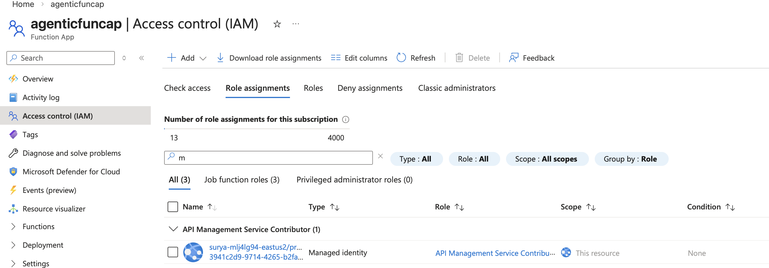

    3.Please do not rely on IAM (RBAC) for inbound calls
    • RBAC controls resource management only
    • HTTP access is governed by Entra ID authentication
